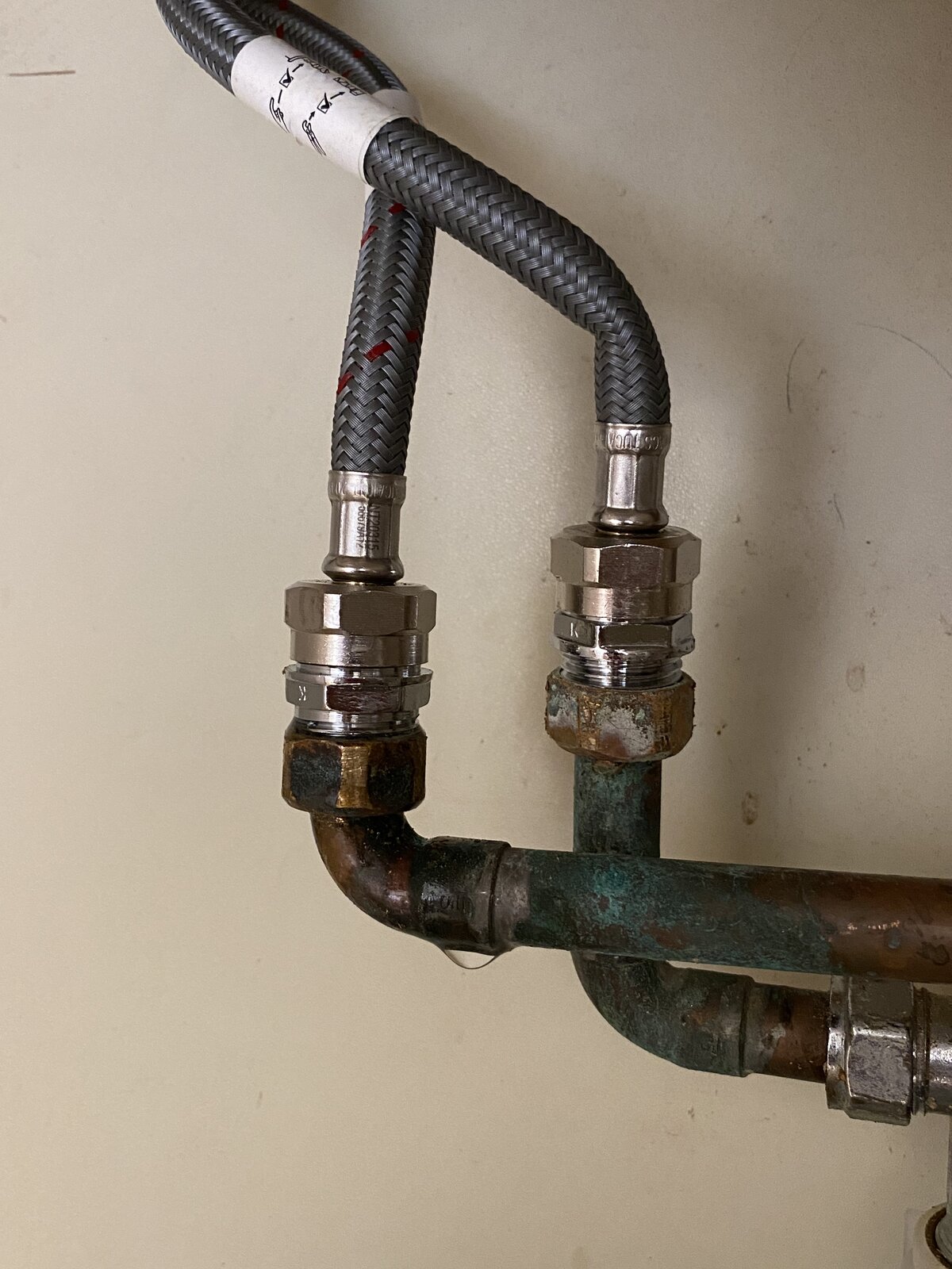

Hi all,
First time trying to figure out how to fit a sink in the kitchen.
I’ve got stuck at the flexi hose going to the monobloc tap. As you will see from the picture, I’ve connected the hose directly to the copper pipe but it’s leaking a bit. Most videos I’ve seen connect to a straight pipe and attach with an olive but I can’t as the copper pipe has the threaded bit on the end.
I’ve also realised the hose is too long and bending so I’ve bought a shorter one.
I also realise one of them isn’t tightened fully but the one on the left is leaking having being tighten as much as I can! Help!
1. When you say "the copper pipe has the threaded bit on the end" do you mean that it has a brass nut with a female thread on the end?
2. If so, then the copper pipe has either:
2a. A compression fitting with olive on the end.
2b. A tap connector with a flat flange on the end.
3. If 2a, then:
3a. Get a male compression iron (they are made of brass) like Screwfix 69358.
3b. Use the compression end to attach to the pipe. The existing nut should fit, and you may get away with re-using the olive. Wrap some PTFE tape around the olive before connecting if you are reusing it.
3c. Use the screw threaded end to attach the flexi. You will have to remove and discard the chrome male threaded adaptor.
4. If 2b, then:
4a. You might get away with adding a 1/2" fibre washer to each tap connector and screwing the chrome adaptors in. Bit of a bodge.
4b. Otherwise you will need to cut off the tap connectors and go back to bare pipe. You could use the male irons mentioned above, using the compression nuts and olives that come with them.
4c. If you have to cut back the copper pipework, it might be easier to go back to the isolation valves and fit new pipework from the valves to where the flexis need to terminate.
5. You are quite right, the kinked flexi should be replaced.
There should be a rubber seal in place between the flexi hose nut and the silver ,threaded fitting. Is there one ?
The silver coloured fitting that is on the copper pipe may not be flat faced ,and unsuitable.
Can you remove the flexi hose from it and show a picture ,in close up ,of that silver fittings threaded end ?
Really helpful replies! Right I’ll switch the water off and disconnect the hoses so I can take a photo!
Looks like it’s leaking from that bent tap connector.
Fit the flexi pipes directly onto the (flat faced) isolators. (bottom right of picture).
1. Given that the visible isolator has copper tubing on the output side, and a compression fitting for it, it seems unlikely to me that it is flat faced.
2. Also doesn't look as if the current flexis would reach it.
