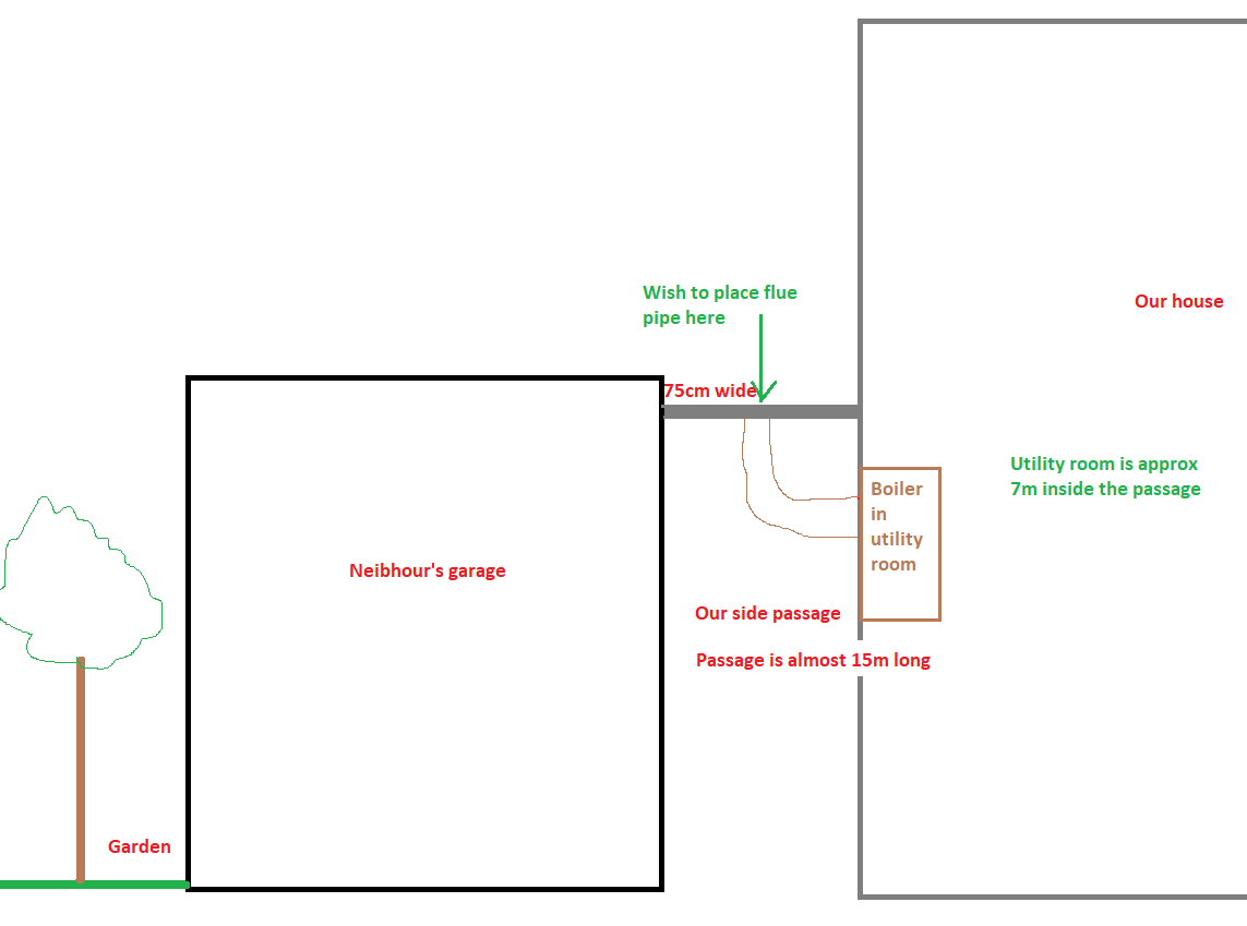

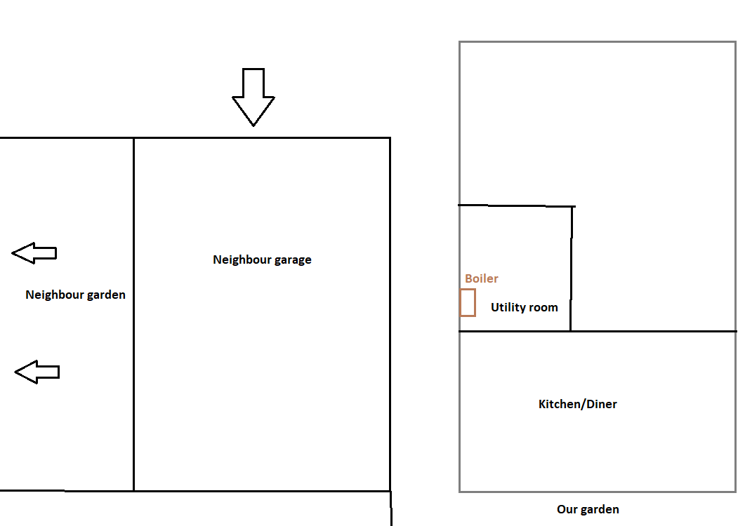

I am looking at several diagrams but it's not clear to me what the regulation says about the distance a flue pipe from a neighbours boundary. I've seen 300 and 600mm.
II would like to route our pipe from our side passage, coming out from a wall in the utility room, with an elbow joint and protruding upwards through the roof covering the side passage. The passage is around 750mm wide. The neighbours side is a flat roof garage which is 2m wide, and then comes his garden, and his house about 25m away. He will not be affected by any exhaust gases and neither will he ever get permission to build anything in the spot that is his garage.
If I place the flue 300mm from my wall, I have 450mm free from his side. The prevailing wind here suggests the gases will never carry to him but get smacked against my wall. He was originally OK with the distance but has asked me to extend the pipe 1m on top of the side passage roof. My plumber says this is a bad idea. It certainly feels like it.
Any thoughts or suggestions? The alternative is to extend the flue about 10m down the side passage and into the garden.

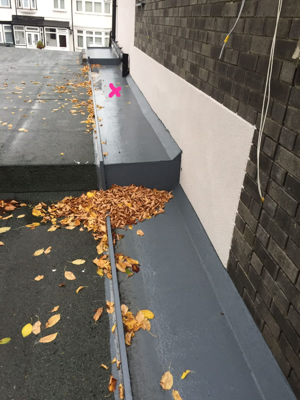

The side passage roof in question:
View looking from garden at our house. The garage represents the boundary, and a fence in line with this carries on.

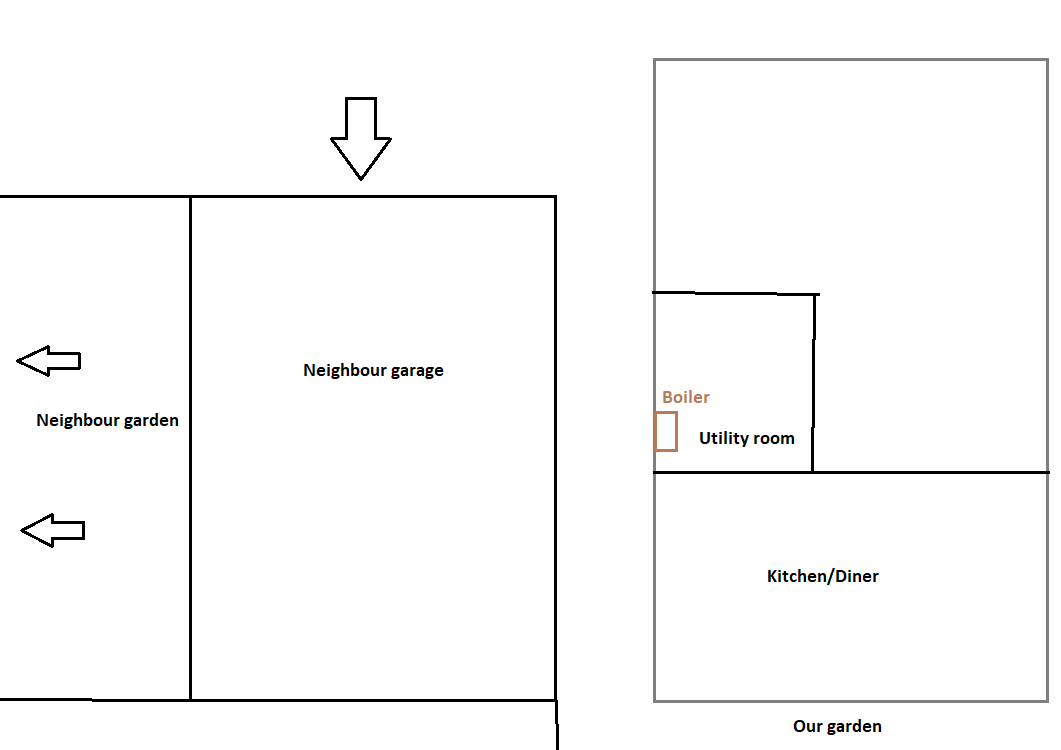

Plan view:

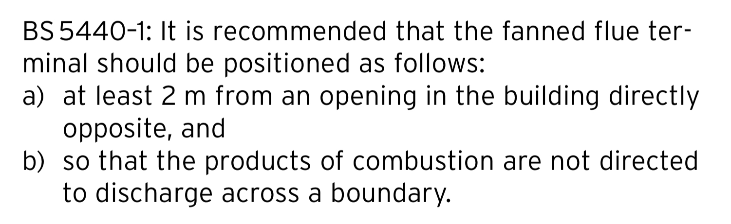

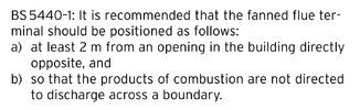

I would get it so that the flue terminal is horizontal to the boundary, not pointing at it, and keep it to 300mm or greater. See attachment.

Thanks. Could you please expand on those acronyms? And it's too late. Kitchen is all done. Builder let me down with late planning and design of plumbing solution.

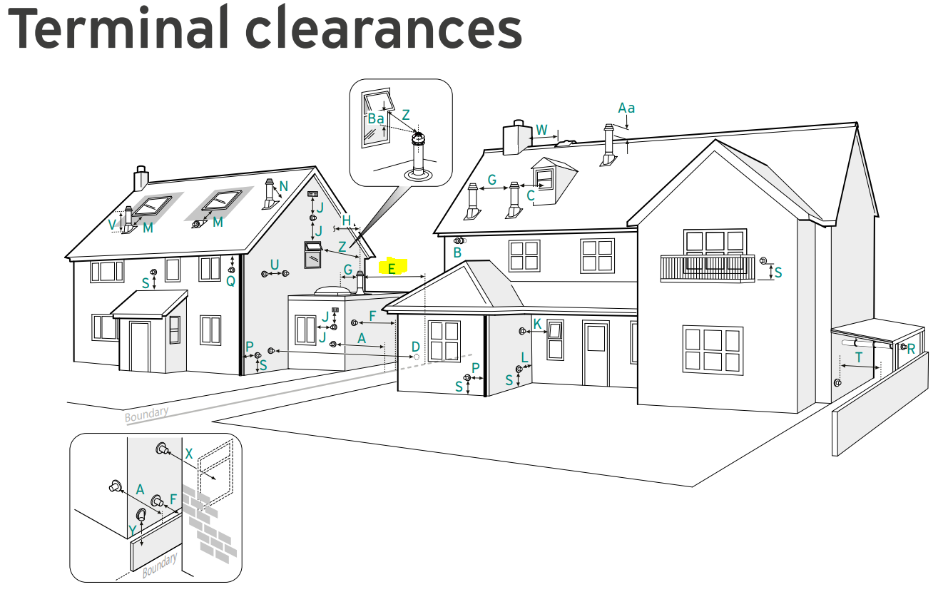

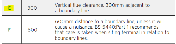

I may have been confused by the terminology. Below is the clearance diagram from Vaillant. When they say "vertical flue clearance" in the below diagram/chart, they mean the horizontal clearance of a vertical flue! Looking at it with fresh pair of eyes (we get wiser by the minute), I think I'm OK with 300mm from the boundary? On a scale of 1-5, with 1 being STRONGLY AGREE and 5 being STRONGLY DISAGREE, what would you say? :)
Yes, 300mm to boundary and house wall will be ok.
Observe distances "G" and "E" and, if relevant, "Z".
On the basis of info supplied you're good to go.
You need 300mm to the boundary (distance E) and it needs to be 500mm from the wall of your house (distance H). Given that your passage is only 750mm wide, this cannot be achieved.

Anyway, back to the issue at hand. 300mm+500mm+110mm flue diameter is 910mm width required in order to comply with the installation instructions.
