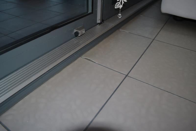

I've just exchanged on an apartment that has Amtico fitted to the open plan kitchen/ dining/ lounge area. The previous owners had it put down in about 2007 and I have the original receipt showing there is 6mm plywood fitted beneath.
It has started to lift on one of the edges. I suspect because its got too hot and there is no room for it to expand?
The edge where it is lifting is on the outside edge of the room that borders the winter garden/ balcony - an enclosed balcony basically.
See photos. ANy suggestions?
Stuart
Ooops - someone didnt use high temperature adhesive and the sun has caused the glue to fail
also looks like that tile was cut too big, but hammered down (by jumping on it) - this stress and the sun causing the glue to fail = a popped up tile
Yes it can be fixed, there may be more that will need fixing
I would get a pro in to at least advise you
Fitted correctly, Amtico will not expand and contract, that looks repairable but get a pro in to advise and do it properly.
Do you have any spare tiles? The door might of expanded a bit. Best to cut tiles a fraction short on doors that are in the sun. Nothing to do with HT adhesive, the sun makes the tiles shrink an they don't go back.
