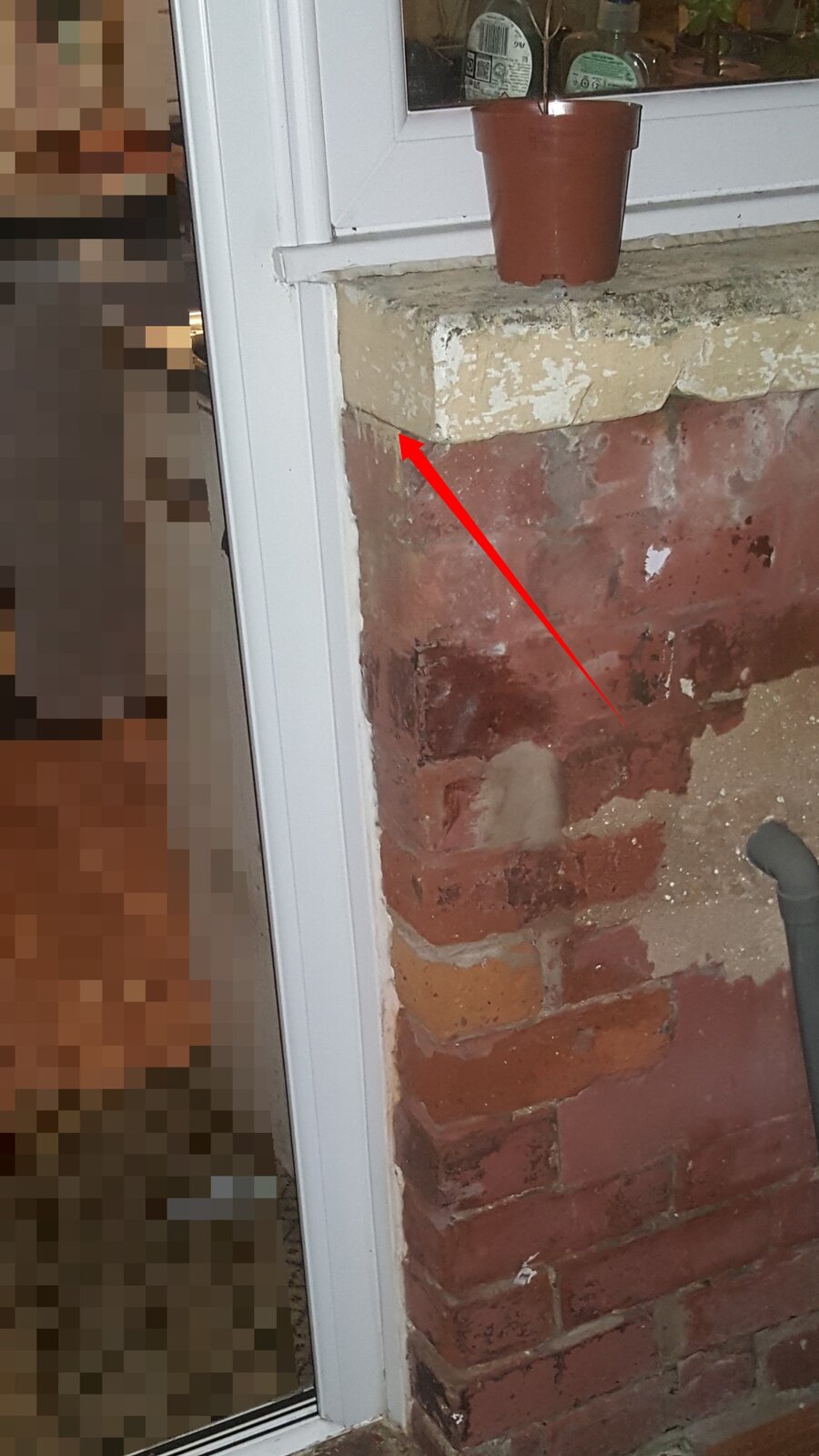

Hi how would a plasterer render this corner at the edge of sill as it would protrude. Plus would they remove finish bead and render up to upvc frame thanx.
That sill should be overlapping the wall with a drip its shouldent be level with the wall, what you can so is clad it with a plastic sill take the lower bead off and then render
