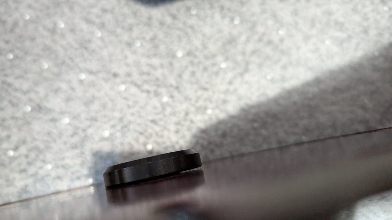

Do angle grinders in the UK have different arbor sizes? I assumed it would be standard, but some grinder discs are sold as 22mm bore, others 22.2mm.
I recently purchased a 230mm diamond cutting disc, I have tried it on two different 230mm grinders (Titan and Hikoki) and it will not fit over the flange nut on either, it is always slightly at an angle and subsequently wobbles when it spins.
Do I have a defective disc that doesn't quite meet tolerance, or have I purchased one with the wrong bore size?

It isn't the outer nut that's the issue, its the inner one, which has an arbor the disc bore is supposed to fit over
If the new cutting disc isn't snug onto it's arbor then you have a very dangerous situation......I think we need some pics of the problem now!
John :)
Its not an easy problem to take a photo of - I've had to take the washer off the grinder to try and demonstrate - the fit between the arbor on the inner nut (washer?) and the bore on the disc itself is so snug it won't fully go over it and sit flat
The cutting disc I bought was sold as having a 22mm bore, have I bought the wrong disc and I just need to go buy one with a 22.2mm bore? Seems like such a small and odd difference in bore size!
Personally I'd say that when 22mm bore is mentioned it's actually 22.2 - but who's to know the difference?
It's a bit vague from your pic, but the driving dog on the grinder needs a spigot to hold the disc on square and tight - or this may be achieved by the secondary nut.
On the set up I see here, what happens if that nut is backed off, reversed and relocated?

For context, this is a new corded 230mm grinder and disc I've just bought, as my 20V Parkside cordless 115mm grinder wasn't quite up to cutting some concrete paving slabs.
I've just tried all the discs I have for my 115mm grinder (which have the same 22mm bore) and they all fit over the arbor on the 230mm grinder perfectly, so it would seem the issue is the bore on the 230mm disc I bought is slightly under tolerance and won't fit snugly.
For sure, the bore should be 22.2mm......I can't see what's going on here!

As above. The arbor is 22mm, the disc hole should be 22.2mm (or 22.23mm)
