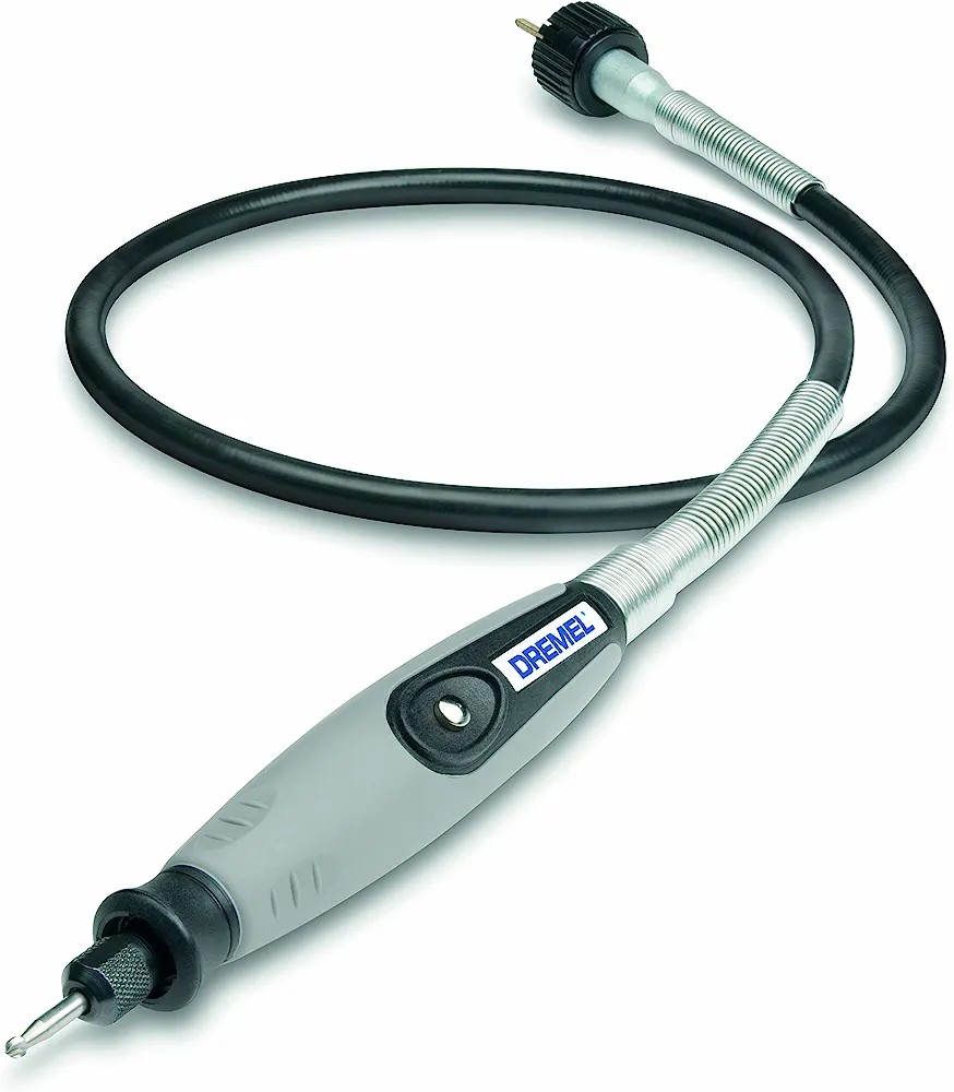

You say a Dremel won't reach, but surely with the flexible shaft it would, wouldn't it?

i have loads of dremel stuff, but the paint is 70 years old and buggered by the stripper.
even a 4” wheel and flexible shaft on a full drill isn’t man enough.
