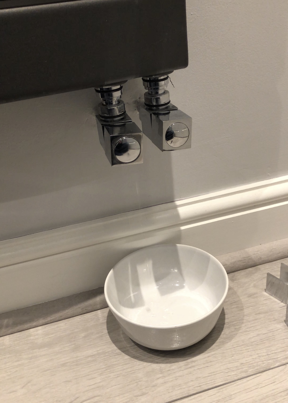

I've gone into the bathroom tonight and found that the towel rail has been leaking for most of the day. Thankfully the flooring is sufficient and that the water hasn't gone anywhere.
Anyway, upon inspection it appears as though the existing "angled valves" are leaking. After speaking to a friend, it was suggested the circular bits on the valve at the front may be caps and may pop off allowing adjustment/tightening, anyway, for love nor money I cannot remove them.
We have the exact same valves in our ensuite, so I investigated those to see if it was just that "cap" that had corroded in place or something, and sure enough after a little bit of persuasion, these valves have now decided to leak.
I have no real way of identifying the brand of valve that is currently installed, but I suspect they're similar to/identical to these --> https://www.screwfix.com/p/chrome-cube-angled-radiator-valve-15mm-x-2-pack/98904
After reading the reviews, they seem to suggest a ~1-3 year lifespan, and leaking with no adjustable option to fix them... Sounds very similar!

I’ve got some small enough tools that would pry them off if I was to persevere, my worry is that as soon as I touch them, they gush, which makes me think there nothing of any use behind them :(
And that I’m just going to make things worse.
Yup, they use 1/4 turn ceramic inserts with internals and seals that were never designed to take the rigors and chemicals inherent to CH systems. Have had to swap out loads of them.
Normal screw down valves are the only ones that should ever really be used until they sort out the design issues. You won't get square headed valve like that in screw down form I don't think. You will have to change the look.

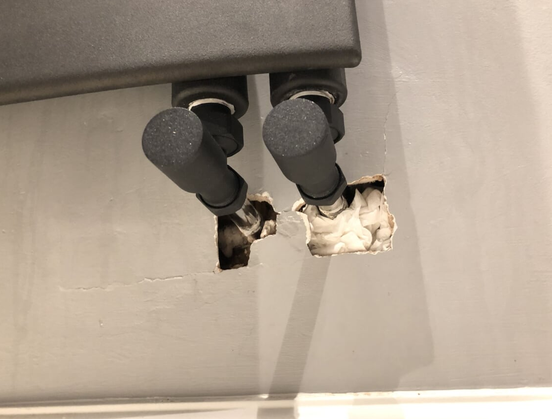

Sorted, after removing the Chrome Angled valves, it was clear to see why they were leaking. Even when closed you could see daylight. It was also clear to see how the mechanism massively differs from screw down valves. The only thing they were good for is weighing in!
