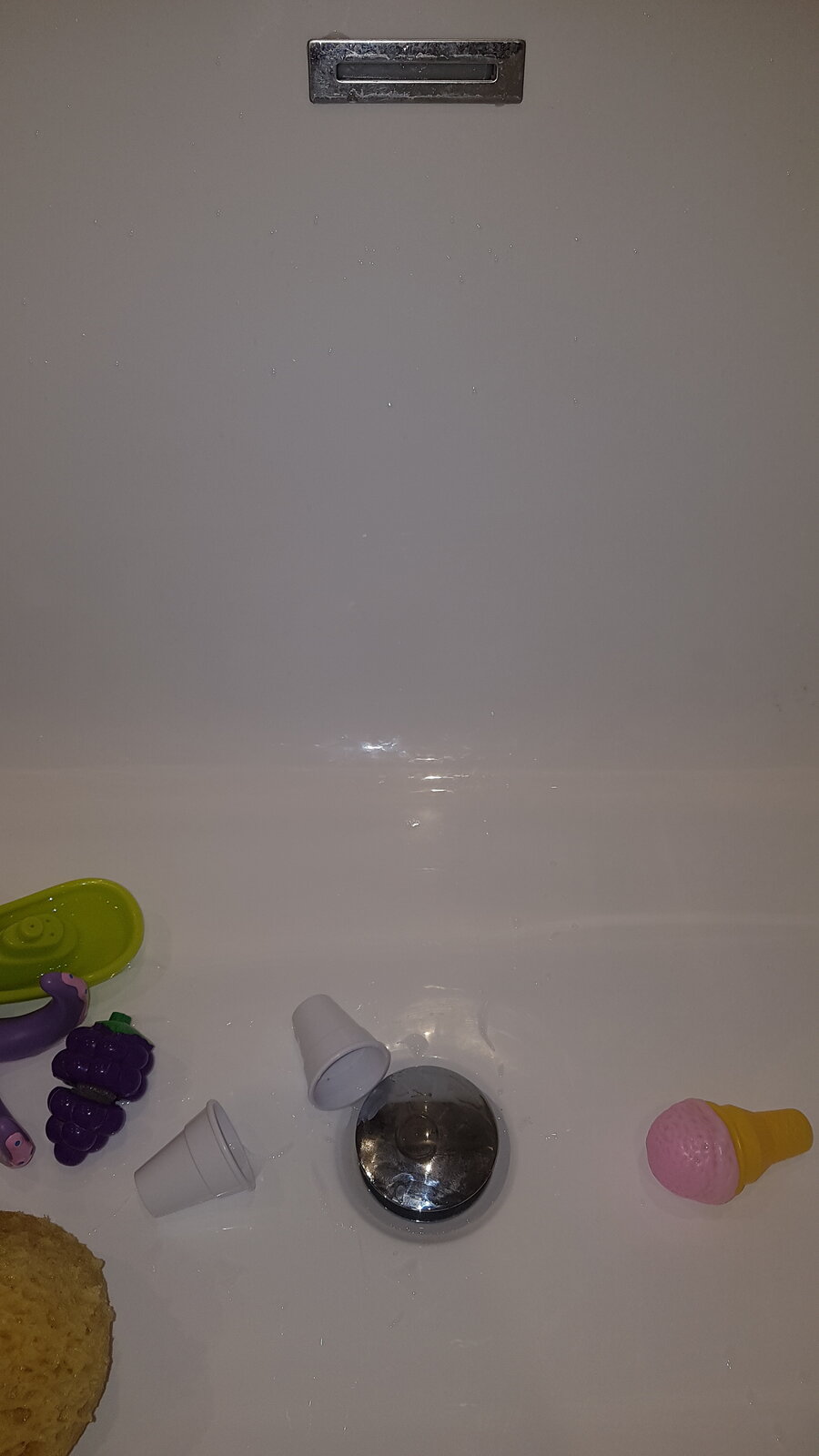

Put in a new freestanding bath wifey decided on.
The plug is a "push" thing with built in waste.
Every time I have a bath I sit on the plug, which depresses and drains water.
The waste overflow is a horizontal bar, rather than a round one
Lile the pic below (which is a random exanplez not my bathroom)
Can anyone suggest / provide a link for better waste, that will fit, that doesn't depress each time you have a bath... I can only find wastes with round overflows

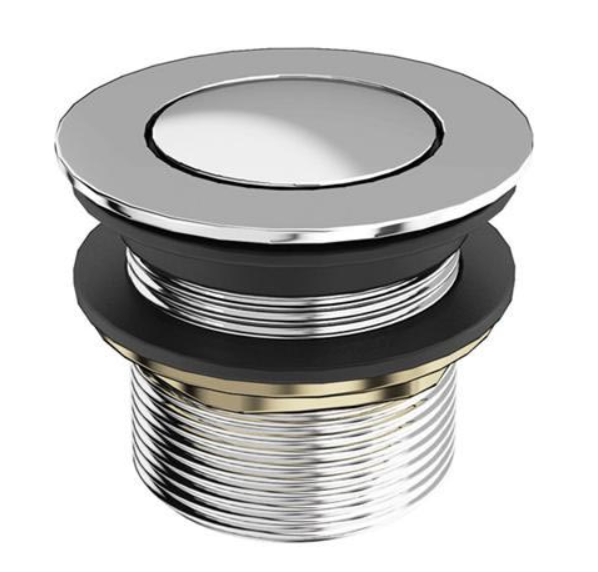

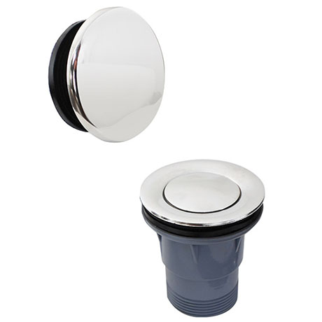

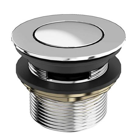

So I need a slotted waste. There are 2 of that style available.
I hope that the connections are all standard, as the rectange overflow on the bath is attached / inaccessible, however, the overflow pipe connects to the existing waste is.
Will either of these be suitable, or, preferable? Will the first just be a direct swap/standard thread?

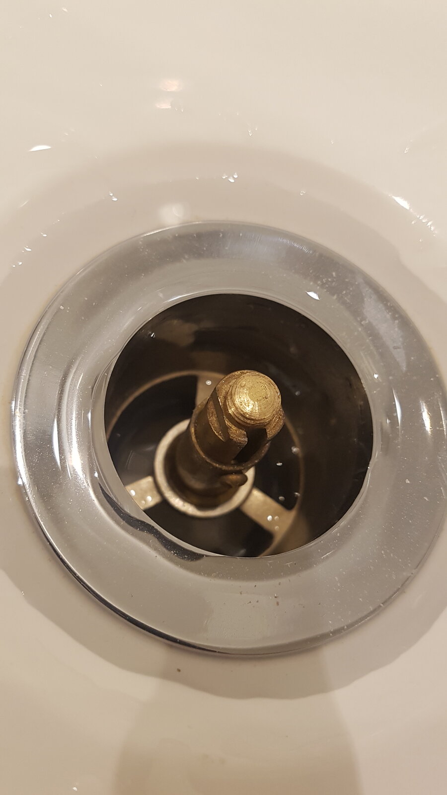

For reference, the one to replace is this

Show us a pic of your actual bath. If you do not have access to beneath the bath you can't change the waste.
Your overflow and waste may be a combined unit ,and not interchangeable.

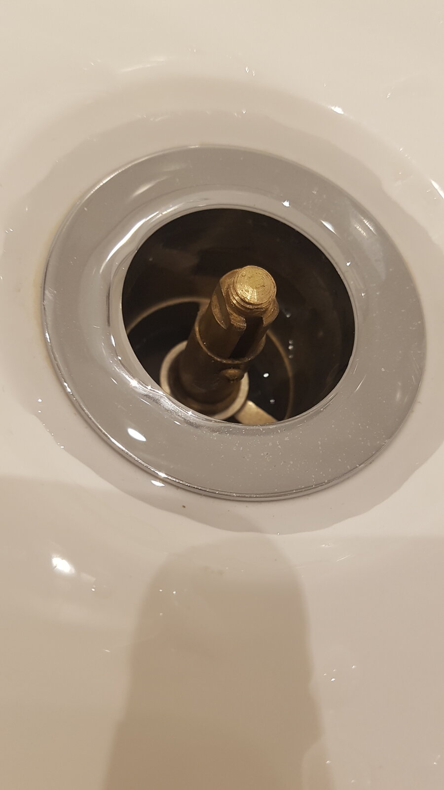

Apologies - I am going senile. Just lifted the bath and there's not a waste pipe. Its a combined unit.
I unscrewed the thingy and it looks slotted like the second one
So i reckon the second one? Or am I stuck with this mushroom?

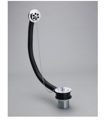

Not come across any baths that need a slotted waste! They all go via a ribbed hose into the bath trap IME!
Tomorrow Ill lift bath again and take pics.
Nine of the above is visible - all sealed behind a fiberglass shell.
Looks like I can just unscrew the waste and put a new one it. The existing one is slotted, you can just tell from the photos.
