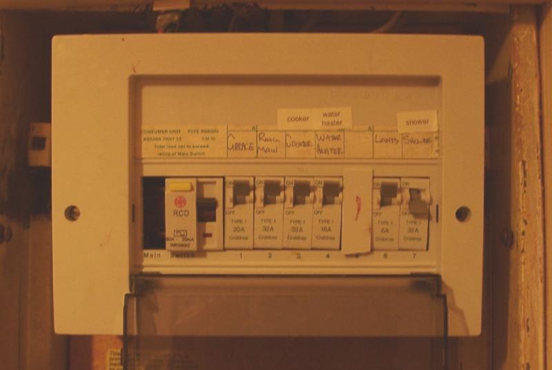

Can you provide a photo of the consumer unit?

Can you post a pic of your Consumer Unit? And also the incoming power cable, company fuse, meter and the wires between them (especially any thick green-and-yellow ones) //www.diynot.com/forums/viewtopic.php?t=129539

I did upload an image in the album named RonPics, but have been unable to transfer it into the forum messages here.
