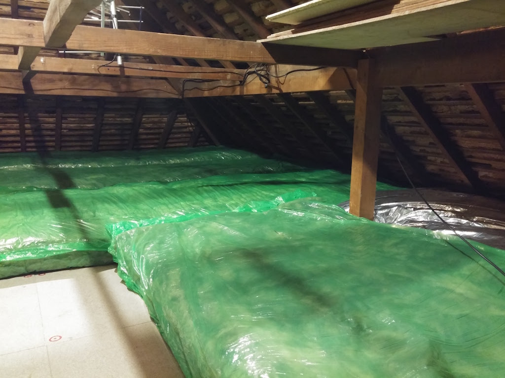

I've now had a roofer do a bit of work as the roof over the bay window started to leak. The felt on top had basically started to split. He did a good job of sorting that out and I got him to re-felt the kitchen flat roof, lovely job. He also fixed a few cracked tiles, and re-pointed the bottom of the chimneys as he thought water may be getting in there.
I've now used a 1 in 5 PVA water mix on the inside on the remaining torching and that seems to have soaked in to the torching and the crumbling powder is now robust and should stay put a fair but longer than it looked like it was going to.
Next job, remove all old mortar off loft floor, remove old loft floor and insulation and re-do it all. A dusty, time consuming job but well worth it when done.

It's stood up really well. I actually went up there earlier, first time in a month or so to see what damage the wind had done and there was no dust and only one small bit or mortar has fallen off since doing the work plus the odd tiny bit here and there. There was certainly a hell of a draft going through the loft and all the woodwork was dry.
I'd probably go for a 1 in 4.5 mix if I was doing it again because some bits of mortar still feel slightly dusty to the touch however in the main everything feels locked together. Oh and I sprayed it on, I started with a hand pump sprayer but that was slow and kept blocking up. In the end I used a garden sprayer which I pumped up, but you have to be careful not to spray too much with one of those.
I also laid wooden battens on top of the existing rafters do I could lay floor boarding down with 100mm insulation down, board over it and then lay 270 space blanket over that. That was well worth doing. The only issue I have is that some of the space blanket is a little wet but I'm happy that is not a leak problem but some minor condensation when the damp cold air goes through the loft and hits the blanket covering. It should dry out when it warms a little. In the meantime the house is a lot warmer and easier to heat now.
I've attached a shot just before I laid down the final few blankets. When I started the loft looked like a set out of a horror movie!
