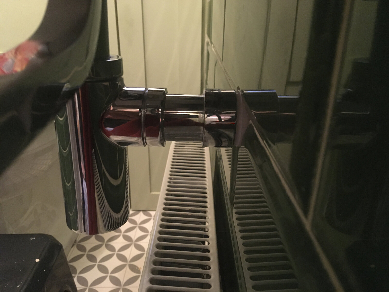

here is how mine looks with the Wolseley adapter
Thanks for taking the time to take a photo of your installation ETAF, it looks good and it does look like the flange on your chrome plated bottle trap pipe covers the chrome plated part of the McAlpine adaptor. I'm not sure (it's difficult to tell), if the flange on the 35mm bottle traps I've been looking at would be as wide as yours.
I can still see a small amount of white plastic, but I guess this is because you couldn't cut the existing white plastic pipe and further into the wall, only flush with the tile wall.
... actually, I've just realised, that what I'm seeing on the right is the McAlpine adaptor, then the chrome plated pipe of the bottle trap, which fits straight into the adaptor. So you didn't use the flange that came with the bottle trap pipe.

NO, i didnt use the mcalpine OR the Flange, the flange would just be a gap between it and the wall and look silly
so the other half was happy with this
to be honest i thought the tiles would have come out further and covered the white
but she was happy and with the radiator and towel, its never seen
as my father-in-law often said, "a blind man would be pleased to see it"
As i posted I used The woresley adapter , and glued onto the existing solvent pipework and the JTM supplied bottle trap
Had i known i could get a bottletrap that fitted , like the mcalpine i would have gone for that
BUT Note I'm a DIYer and not done a lot of this stuff, so the previous posts maybe provide better info
Were I use a flange was in the onsuite - BUT I had full access to the wall either side
Here the pipework already existed and i had no choice as the pipework to the outside was within a wall - which once was an exterior wall and now an internal wall
And i could not change the pipework without a lot of work

Thanks for confirming ETAF, that makes sense.
Just to clarify, although you originally provided a link to the Wolseley website, it was a McAlpine adaptor that was shown :D

Oh yes, sorry i thought you meant the mcalpine trap
yes i used the supplied bottletrap from JTM, the adapter mcalpine from woresley and solvent glue onto the existing pipework.
