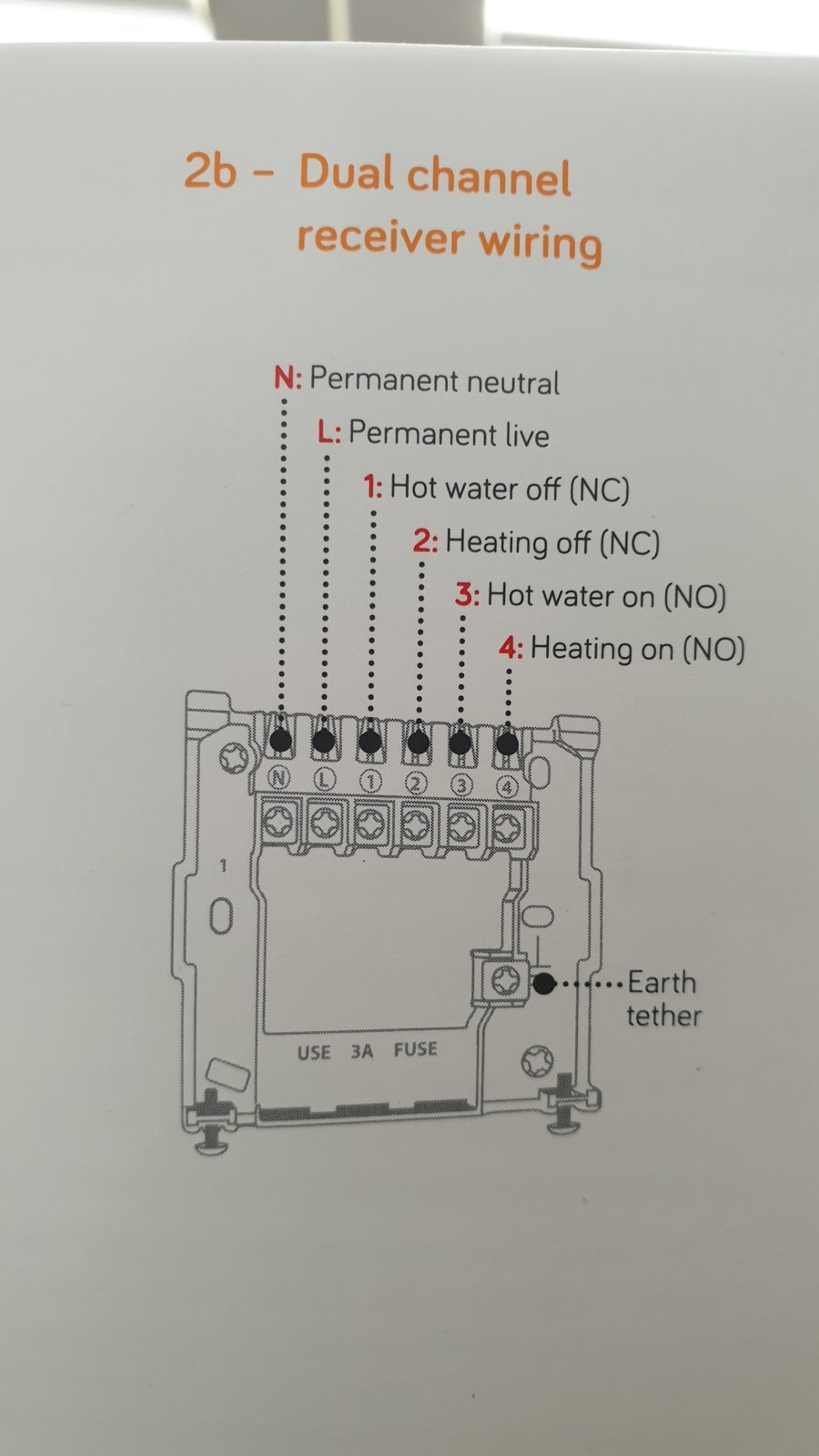

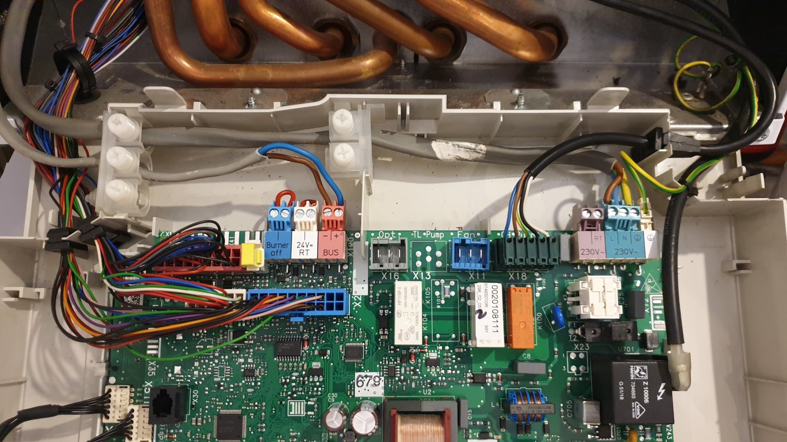

Hi,
I have searched the forum but not found an answer that matches my question.
I have a dual channel Hive and want to wire to my Vaillant 831 Plus combi.
Reading the manual and also the forum. I believe i need to so the following can someone please tell me if its correct.
3 core flex cable
Remove Vaillant thermostat from boiler BUS terminals
Boiler N > Hive N
Boiler L > Hive L
Boiler RT > Hive 4
Many thanks
  1. Remove and make safe the BUS wires from Boiler
  2. Remove the RT 24v link in Boiler
  3. L Boiler to L on Hive
  4. N Boiler to N on Hive
  5. 230v RT Boiler to 4 on Hive
Note: You should be getting a suitably qualified/registered person to check the boiler over on completion as the front panel forms a secondary combustion seal on this appliance.
Thanks very much.. Why does the 24v link need to be removed btw?
If the 24v link was left in, the boiler would just run continuously.
So I did all of this and all seems good. Heating comes on when set from the thermostat and the phone. One thing I have noticed is that if I stop the heating, on the boiler, the radiator symbol for heating goes off as expected but the boiler still makes noise. Left it over 5 mins and it's still making noise but the heating symbol is off and I definitely removed the 24v link. If i turn the hot water on and off the boiler then stops the noise. Will have to get BG to come have a look.
Heating signal goes off, Hive Receiver led should flash for a bit, then make a click noise, then rad symbol on front of boiler should flash for a bit as the boiler “runs on” to clear its heat.
The run on period will depend on the heat left in the heat exchanger.
