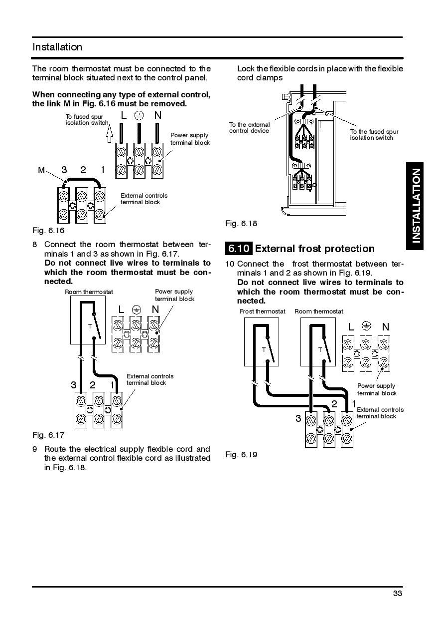

Hi everyone, like most people who do a google search and end up here I've just registered to ask a question regarding my hive installation
My boiler is a combi Biasi M96.sm28/c
here is the wiring diagram
https://ibb.co/NSnYt21
Is it as simple a taking power ( L - E - N ) from the upper block that powers the boiler, disconnecting the old dial type drayton thermostat from terminals 3 and 1 and connecting these to the Hive receiver ?
Any help appreciated
It must be a single channel Hive, The dual channel Hive internally connects 230 volts to it's switch contacts. This will damage the PCB in your boiler.
If your boiler has an internal timer, this will have to be set to constantly on, and the hive will override it, if you dont set it to constantly on they will conflict with each other
cheers, Ian .. I worked this out after I'd finished installing and it wouldn't fire up.. thanks for the help everyone
