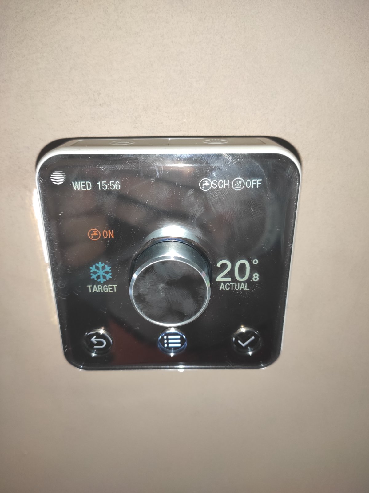

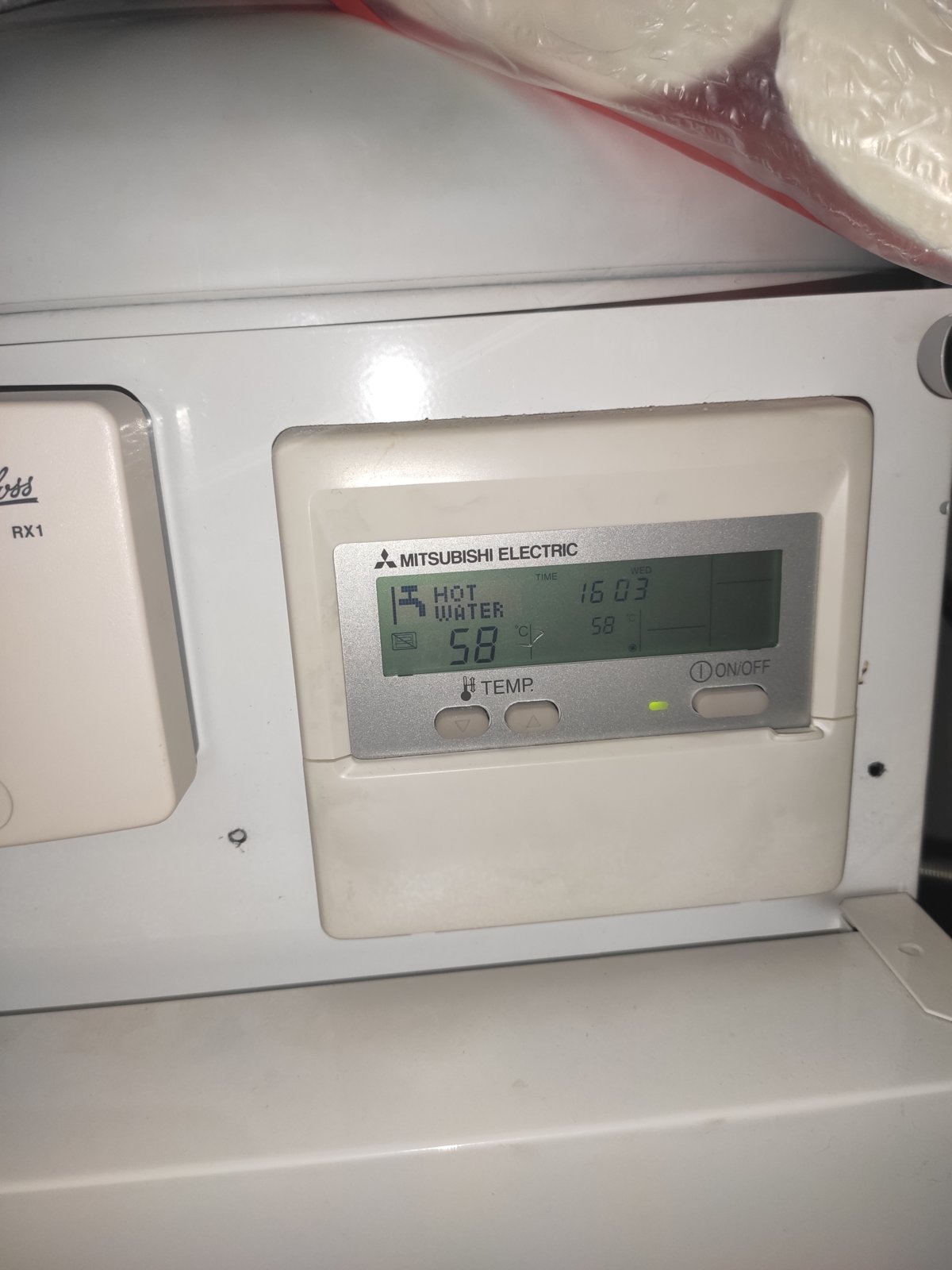

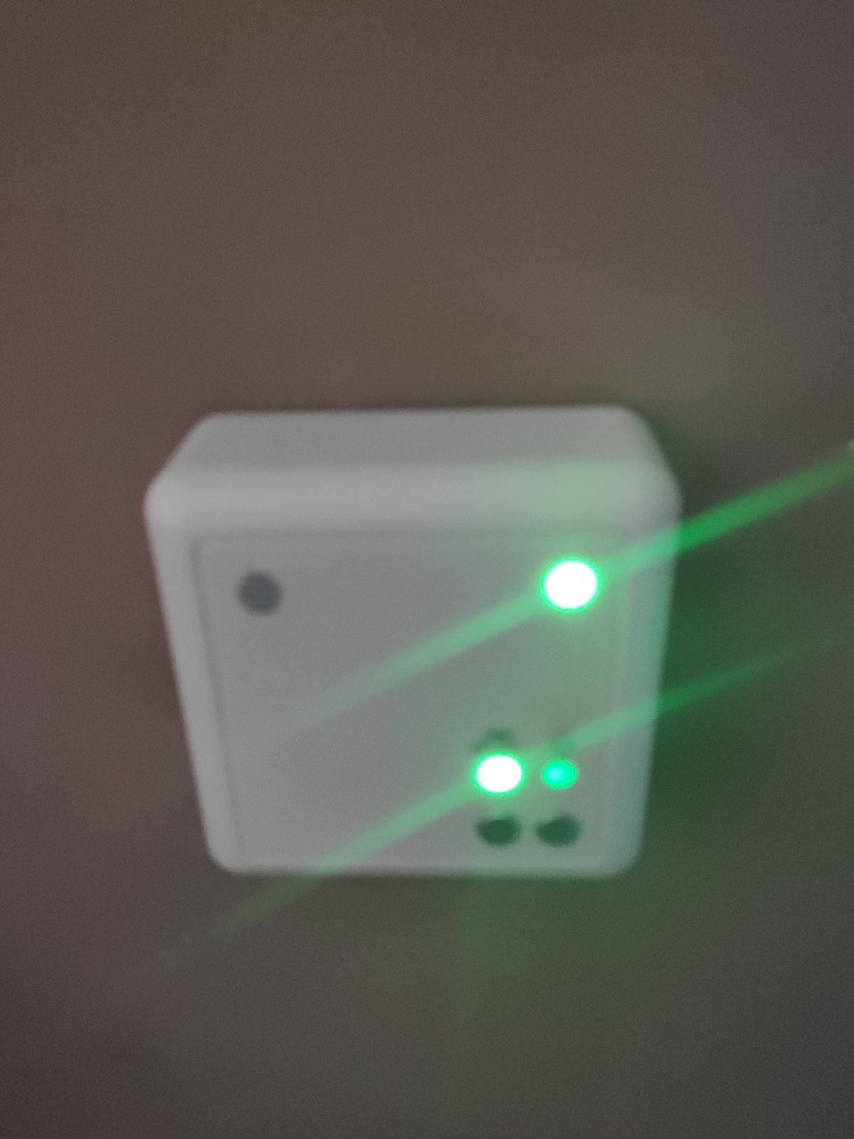

I bought hive yesterday and got it working 100 percent...
You must remove danfoss 715 and replace with hive unit..
Rx1 stays in place..but cables must be corrected
Tp5000 remove + remove battery too..as it send WiFi signal
First FOTO.. showing water is on.. -that is where old 715 danfoss was
  • 2nd FOTO showing that water is heated ( by tank)
  • 3rd photo wireless thermostat -replacing tp5000

Cable in rx1 as following
  • N
  • L
  • 1-empty
  • 2- as it js
  • 3empty
  • 4 cable from no3 goes to no 4
Hot water will work for you all the time..as it bypass rx1..
Rx1 is for heating only..so only that needs to be sorted for working heating..best of luck
Get in touch if you struggle
