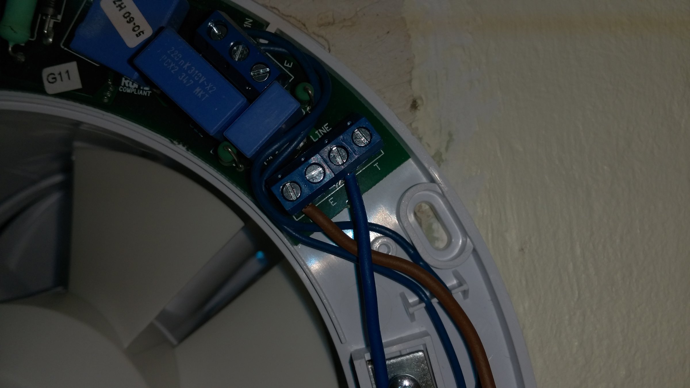

Hmm, the wires are going into the right boxes. I was hoping it would be an easy fix but it seems something else is going on.

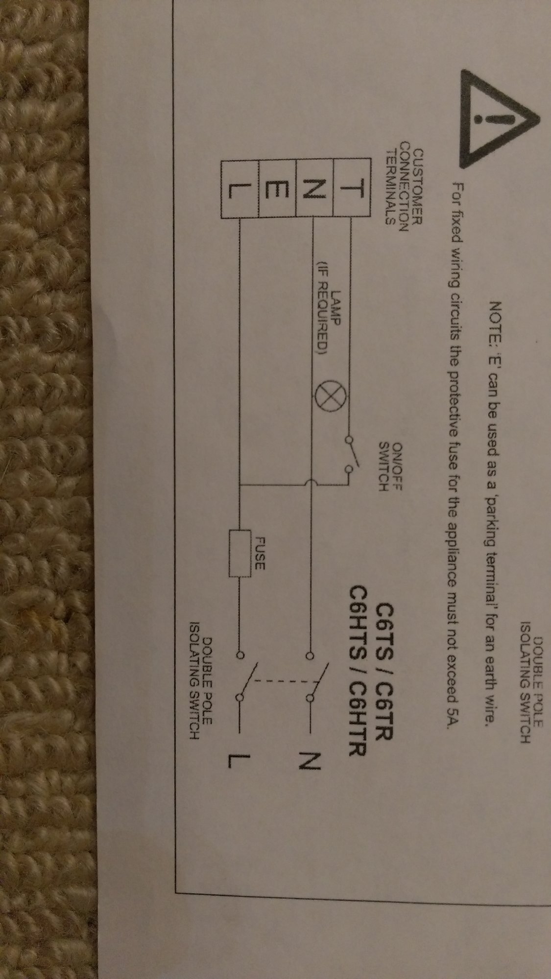

The wiring instructions are below and there is also a paragraph that specifies 3-core in the written instructions, but again I think that's just to allow a switch. Would you think the requirement for the switch and the 3-core actually makes any difference to the fan operation if there is no switch? Would it be possible that there's an issue with our power supply or something, constantly triggering it?
Whilst it compares to the diagram.

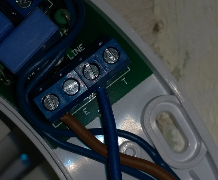

What letters are under the wires?
LINE means the live wire; that looks like the wires should be the other way round.
That was quick TTC. I was going by LINE
Oh, that's a pity.
Well, it LOOKS alright, then.
Also, it looks like it should have an earth. I wouldn't think that is anything to do with the problem.

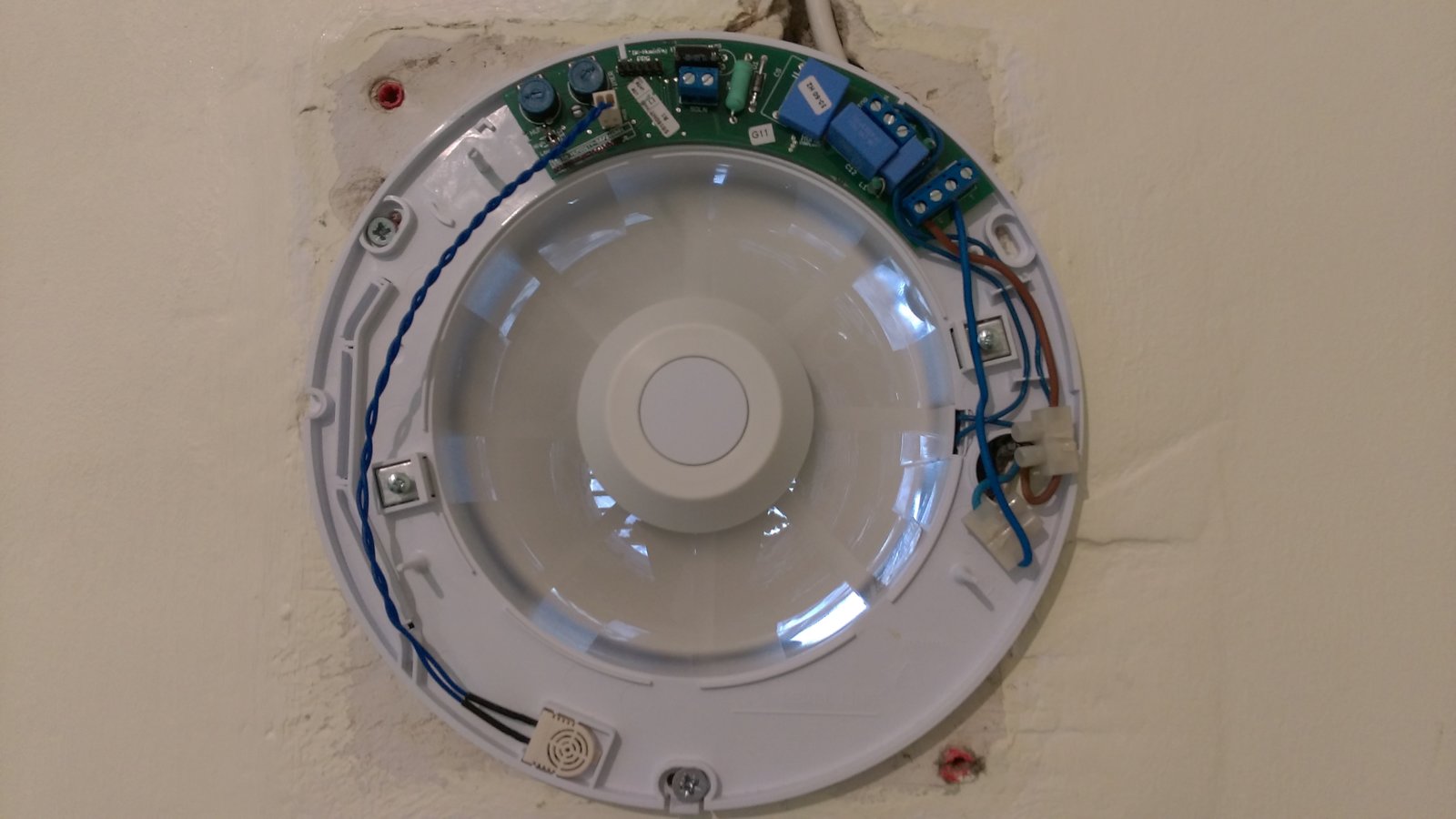

Another piece of the puzzle. Today plugged the humidistat back in and it started straight away, which was good because I was about to have a shower. Post-shower, most of the steam gone, I unplugged the humidistat again. The fan stopped straight away whereas the other day it carried on all night. Any ideas?
Here's what it looks like. The humidistat is attached to the blue cable on the left. The humidistat potentiometer is the blue cylinder on the left, the timer potentiometer is the one on the right. The timer is set to its minimum of 30s, so theoretically I think it should run for 30s after the humidistat is unplugged, but it either stops straight away or carries on forever.
Any ideas?
