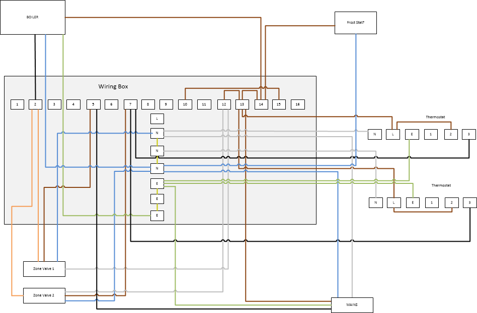

Not sure if this should go in here or the Plumbing and Central Heating forum, but here goes anyway.
I have the following components in my new build house;
  • Ideal Logic Combi ESP1 35 Condensing Boiler
  • Honeywell Frost Protection (L641B1004)
  • Honeywell Outdoor Temperature Sensor (SO10076)
  • 2 x Danfoss TP5000 Thermostat/Programmer

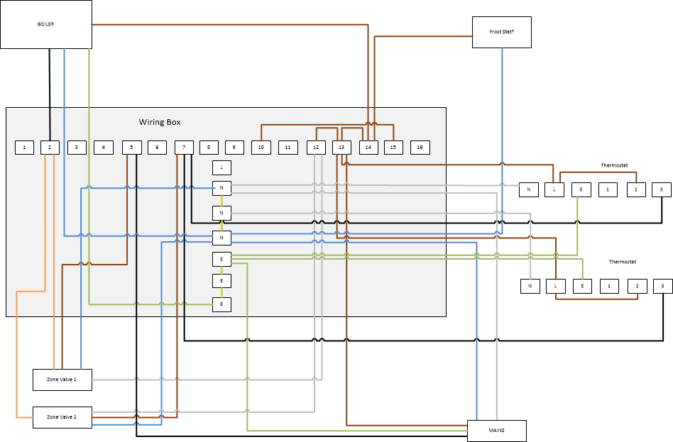

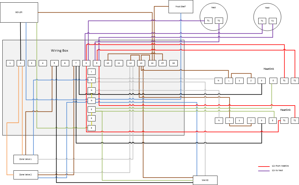

Both of the TP5000's are wired back to a wiring box at the boiler. I've reviewed the wiring in this and diagrammed it to trace what goes where. I've attached this and another diagram of my proposed changes. I'd appreciate it if someone can give it a once over to see if it looks okay.

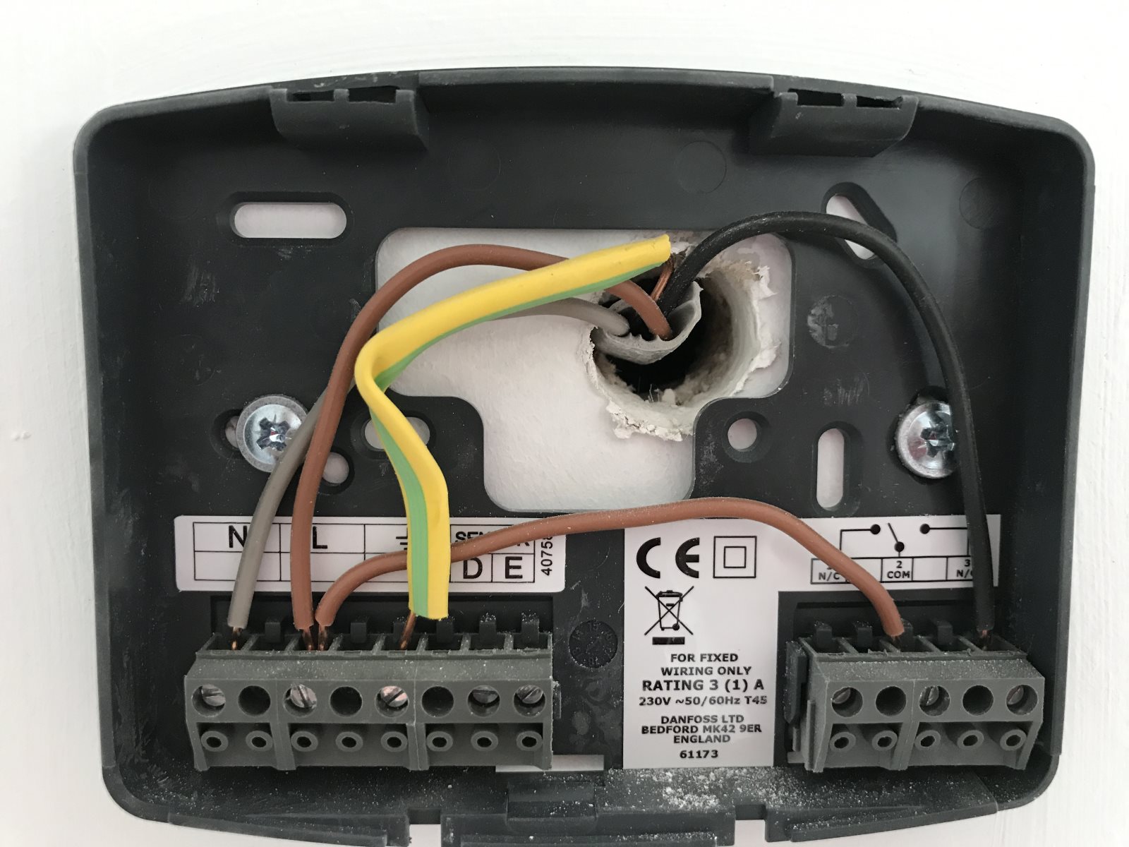

The wiring for the TP5000's is buried in the walls and only surfaces right next to the wiring box. So this means I'm going to need to feed the 240v to the Heat Links from the wiring box and then the 12v from the Heat Links back to the wiring box and then back to the Nest controllers.
Thanks.

It would seem the two thermostats are wired in parallel, I can see with old thermostats how you may want two to bring on the boiler, in fact that is what I have with mothers house, however whole idea of Nest is they integrate with eTRV's and other devices using the ITTT system. So question is why two thermostats?
Some times you have to stand back and ask, what is that for? So with a modern house the boiler is condensate type which means the flame varies in height, the radiators are fitted with TRV's so the TRV's tell the boiler either by return water temperature or back pressure what flame height is required keeping the house at the set temperatures for each room with a seamless variation of boiler output.
However as the weather warms up the boiler starts to cycle, so at some point you need something to turn off the boiler, there are exceptions with open plan houses, but in the main that's how it works, so in some room (that could also be a hall) you fit a thermostat to switch off the boiler as the weather getting warmer, this needs to be a room with no other forms of heating, with no doors to outside and the coolest in the house.
In my house there is no such room, so to keep down installation cost I have used two thermostats, one in hall, one in kitchen, the latter is only active over night, and the temperature in the hall stays static there is only two options, on or off, the temperature is matched to the TRV so is never altered.
To jump to next stage of control means linking a Nest or Hive to the eTRV's with follow commands, to be frank, simply no point in taking this half hearted approach, either you want the eTRV to connect to a hub which in turn controls boiler, so if any eTRV reports target is greater than current then boiler runs, in which case you don't need a wall thermostat, or some other form of zone control. So thermostat controls a motorised valve which in turn controls boiler, so you can set it so upstairs and downstairs are independent.
Now you show two zone valves, which at first glance seemed fine, but one seems to be controlled by something labelled "Mains" and the other by the two thermostats. Zone valve 2 seems to be controlled by both thermostats, and zone valve 1 by "Mains" what ever that is, I will guess cylinder stat?
Now for a non programmable thermostat have two at different temperatures with a time switch to select one for night and one for day makes some sense. But the Danfoss TP5000 Thermostat/Programmer is a complex unit and I can't work out why you have two? I also can't see an advantage using Nest? the Danfoss TP5000 Thermostat/Programmer has all sorts of gadgets, from window sensing to switch off central heating if window is opened to sensing outside temperature, unless you up graded to something like EvoHome there would be little point changing anything.

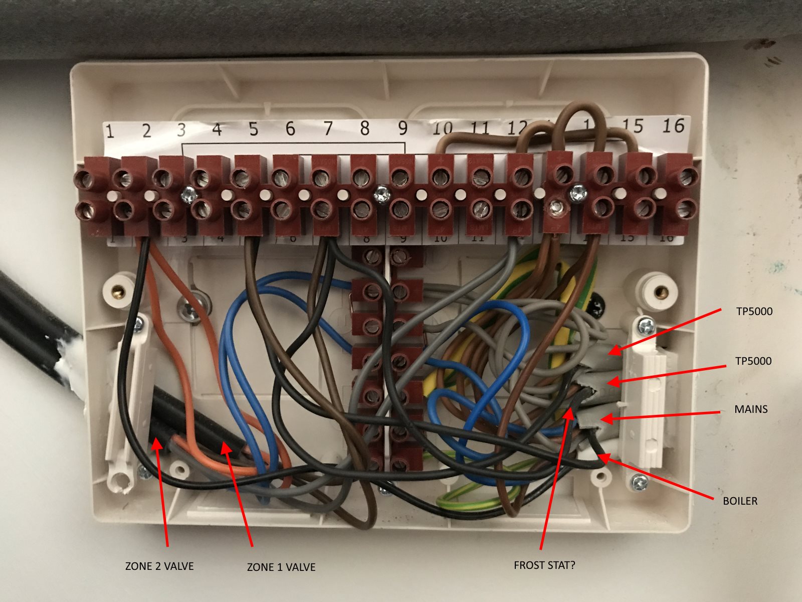

With my diagrams, I made an assumption as to what the source of the cables coming into the right side of the junction box was. I may have this wrong. What is the easiest way to check this?
The top two grey cables I assumed were the TP5000s as they are both 3 core & earth, matching the wiring at the TP5000 end. The power cable for the boiler is white, so I assumed the white cable was the boiler. The bottom grey cable I assumed was the 240v power supply (mains). You can't see it in the photo but behind the bottom grey cable, there's another grey cable, a twin and earth. I'm not sure what this is.
By mains I meant 240v power supply. I don't have a water cylinder.
I have TRVs on all the radiators with the exception of the two rooms with the TP5000s
Answering my own question about figuring out cables. To suss out which two are the TP5000s, I'm going to cut the central heating power at the CU, disconnect one of those grey cables and then work my way through them to see which TP5000s switch off when I disconnect the cables at the junction box.

I expect once traced you will find you have two zones, but likely it will not work as you expect with Nest as controlling just two rooms is not really going to work too well, likely you will want to control all rooms, to drop or raise the hall in my house by 2°C does not cause the other rooms to vary, OK completely off yes, but any small change is compensated by the TRV so hall may get cooler or warmer, but other rooms stay the same.
