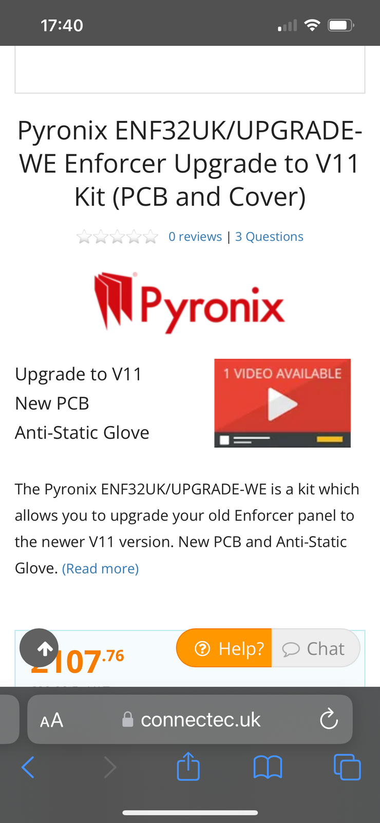

Just bite the bullet and buy a upgrade kit for around £100 relearn everything on and use the app first year free then £36 per year , no further costs and full control of the alarm
TAP is dead , you might find a third party supplier but the cost of each message could be ridiculous …

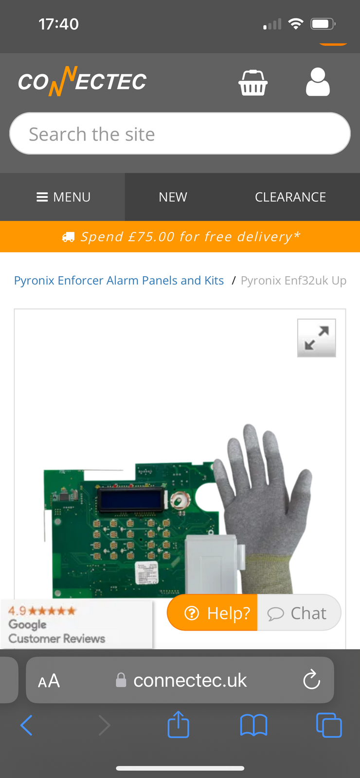

Thanks for the input. By upgrade kit, are you talking about upgrading the panel by adding something to it or replacing it completely? Either way I'd be grateful for specifics as last time I enquired with the installer about moving to VOIP, they wanted £150 to install a GSM dialler + monitoring fees. That was three years ago.
DIY seems problematical given Pyronix won't deal with Joe Public.
Edit
A bit more digging has found the v11 upgrade kit. Presumably installing this would break the hold the installer currently has over the installation? Just need to check the current panel is late enough to upgrade, as it seems to suggest it's only for v9/v10.
As below
