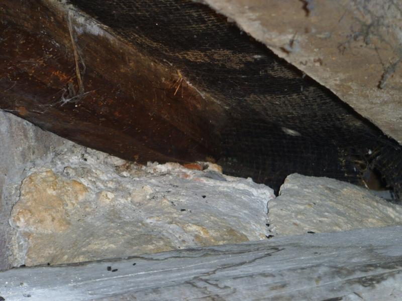

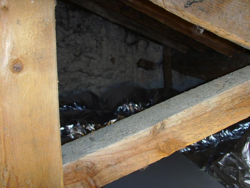

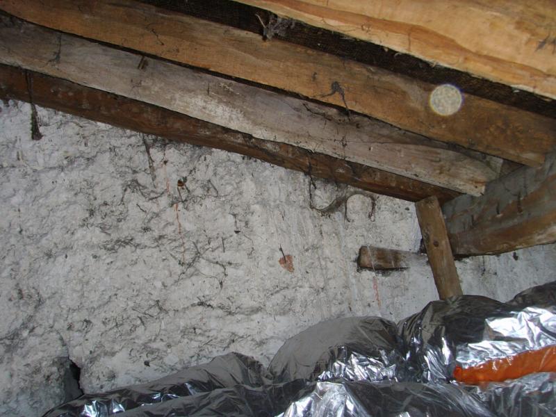

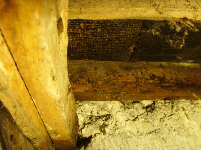

Looking from inside the (very cramped) loft space I found the following - you can see drip marks on the cob wall and the timbers look decidedly dark and wet.
You can see where the felt has ripped and is sagging
(please ignore the mouse poo :) )
Looking back towards that perlin the underside is quite interesting:
Wet!

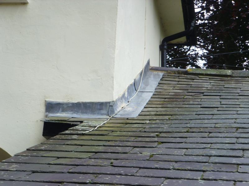

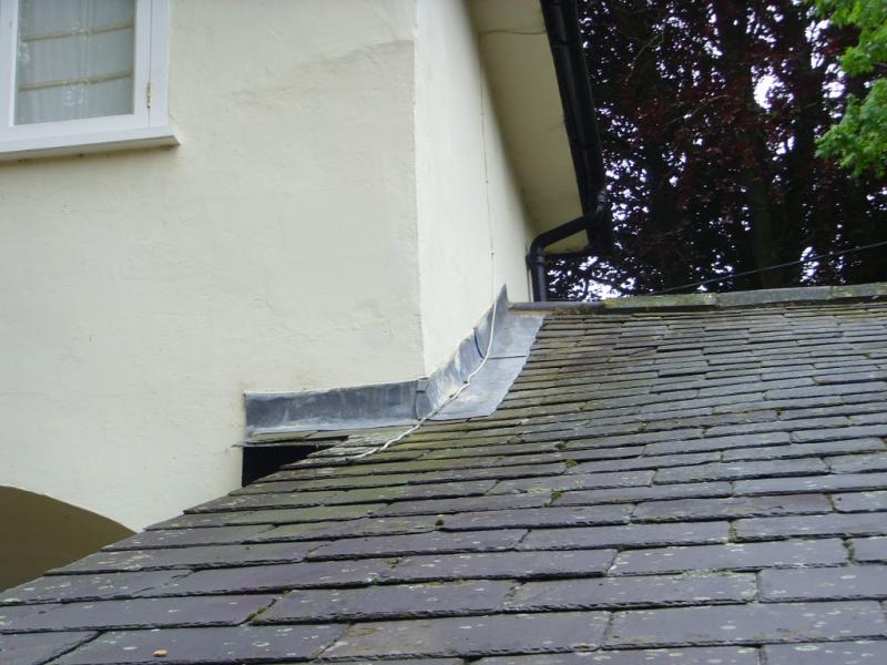

I want to install some leadwork to make everything kosher and dry. Next door has what I assume is soakers with a cover flashing over the top - but it also looks like they've just dressed and bossed the lead over the slates - do they even have soakers I wonder now as I can't see any kick/tell tale lump in the cover flashing where it is dressed over the upstand.....
I don't know if we have soakers present or not, it's certainly not clear from inside the roof (I know they're interleaved in the courses but thought I might be able to see).
So - if we haven't, and I want to fit them, I think it's going to be a case of getting a slate ripper and every other lap - correct? Then running cover flashing over once the slates are replaced.
*Or* and this is the big *or* - would simply having 6" upstand and then a cover flashing coming out 10mm over the middle of the half-slate be sufficient?

The every other method means you have a soaker a full slate length fitted below the slate. That means the lead is not supported until it reaches the next slate below. - Not the right way to do it.
Your soakers should be on top of the slate (and so fully supported) but only one gauge and lap long (plus a bit turned over the top of the slate/batten). Fitted every course.
The lead on the abutment in your photo almost certainly has no soakers in it. There is no point to dressing lead over the slates like that if you have them. You only do lead like that if you are going over a profiled roof tile.
Ahhh interesting - the roofer said to remove every other slate... your justification makes a lot of sense though! Suspect I misunderstood the roofer - confused between laps and slates. With a maximum length of one gague I'll have to remove all slates up that side of the abutment, yes?
Forgive my ignorance but why? If you have the overlap long and dress the lead tightly enough wouldn't it still provide a good waterproof covering? I'd imagine it would take an awful lot of water and wind for the capillary action to traverse the entire led sheet?
The water running down your slates generally runs straight down with a little spread sideways with both wind and volume action. Your lead is not actually fixed where it is dressed over the slate and will to a degree lift.
As the water that does get under the lead goes down the roof slope, it will work towards the edge of the slate which has no "stop edge" like a soaker.
Think of the water coming down a slope several metres long with no edge to prevent it going off the side.
You may be fortunate enough not to have a problem, but the design does not provide the assurance it will not leak that a proper soaker arrangement will. If I can find a publication that illustrates the problem I will update

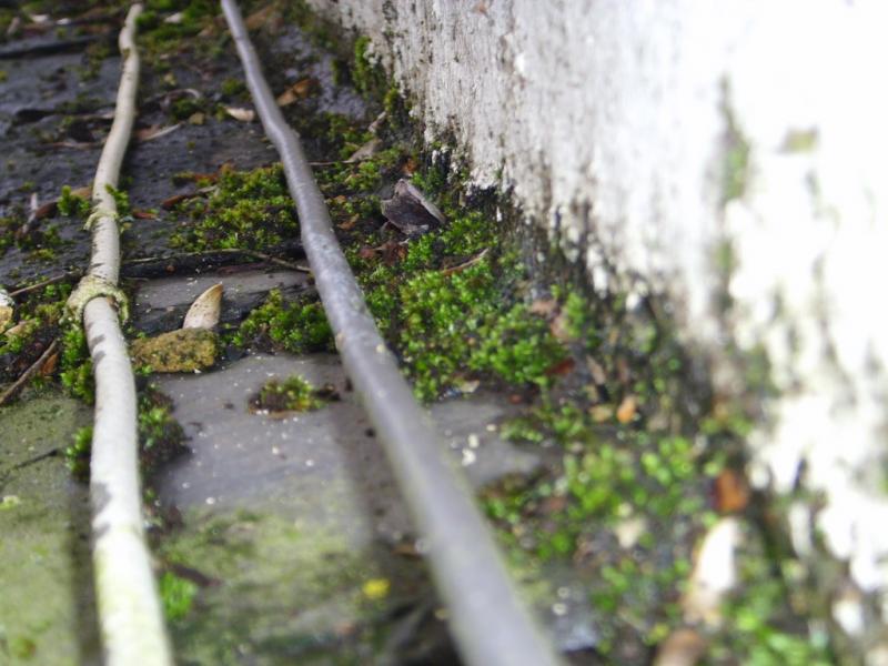

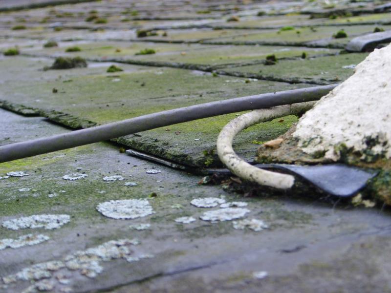

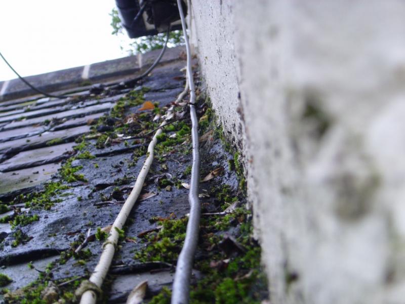

I've just been out with my stumpy ladder and camera and have an interesting update:
I see lead! This makes me think there may be lead present under the laps ... They do appear to be mightily ineffectual but could that be because there's no cover flashing over the top? I've taken a close up as best I can going up the rest of the aspect but I can get little better than a "reach the arm and click"
If it is as I hope then maybe just maybe it'll be a smaller job..?
Your photo makes perfect sense.
Even my own home (1930's era) has similar details. Soakers fitted, turned up the wall and render brought all the way down over the soaker. Covering the soaker with a cement fillet is similar. Both are effective at stopping water running off the roof slope.

If, there are soakers there I really would not expect there to be problem. However, your leak very clearly identifies there is a cause and it needs to be investigated.
I would be inclined to remove the cement fillet above where the leak has occurred and work upwards. I would put money on the fact that whoever re-roofed the property has bodged something or the shear volume of water coming down from that downpipe is spashing up over the fillet (which may have split away from the wall) and is going down the back of any soaker (which I am not convinced have been fitted!).
That bit of lead you see is not turned up the wall as a soaker should be, and is probably just at the bottom to allow the cable in. A slate would really kickup if laid over that cable.
I'm sure all will become clear once you start to uncover things!
Right an illuminating update. After walking 3 miles to and from Brandons to collect the roof ladder (2m + 2m extension) I've decided there's no comfy way to carry a ladder.
Second update: Got the ladder up on the roof and had a good look (no pics yet). Nothing but knackered roofing felt is present and it's just a single thin layer, most of which has holed and fallen apart. I can look through the hole into the corner of the wall and down into the roof ... that's why it leaks!
So, tomorrow brings soakers and 300mm overflashing.
