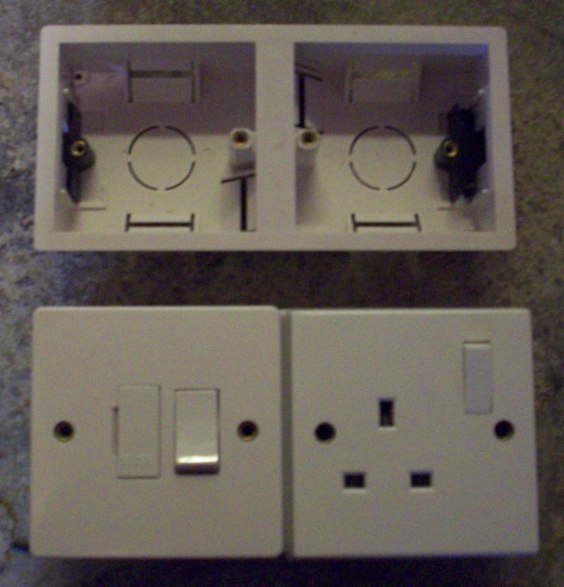

There's nowhere upstream of the double to put a fcu. Guess I'll have to replace the existing double. Are there any doubles with a socket on one side and fcu on the other? A bit like the cooker ones but non-ugly?

Not as such, but if a single socket were adequate for you, you could replace the box the double-socket is in with a dual (not 'double') box, into which you could put an FCU on one side and a single socket (from which you could then spur) next to it. If you needed to retain the socket as a double, you could put an FCU next to it.

OK Thanks. A single is fine for the existing outlet, it's only used for hoovering. Think I'll put a dual there then and just remove/plaster over the blanking plate.

A terminal block behind the double, to a switched fcu on the single and then feeding the hidden sockets and looping back to the double too might be an idea. It means I keep the double withe 'downside' that the switch now turns off the double as well as the hidden sockets.
Maybe that would look better than the dual solution, can't say I've seen a dual in the flesh.
From the room side, it just looks like two single accessories next to one another (with no, or virtually no, gap between them), just as if you had used two single boxes.
The only dual boxes I could find on my shelves were 'plasterboard' ones, but the same principle applies with metal ones. I've tried to show roughly what it would look like with an FCU and single socket installed with one of them (apologies for hastily-taken pic!):
Kind Regards, John
