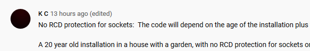

Another one, already the debate in the comments has started:
Age of the installation affects the coding :(
