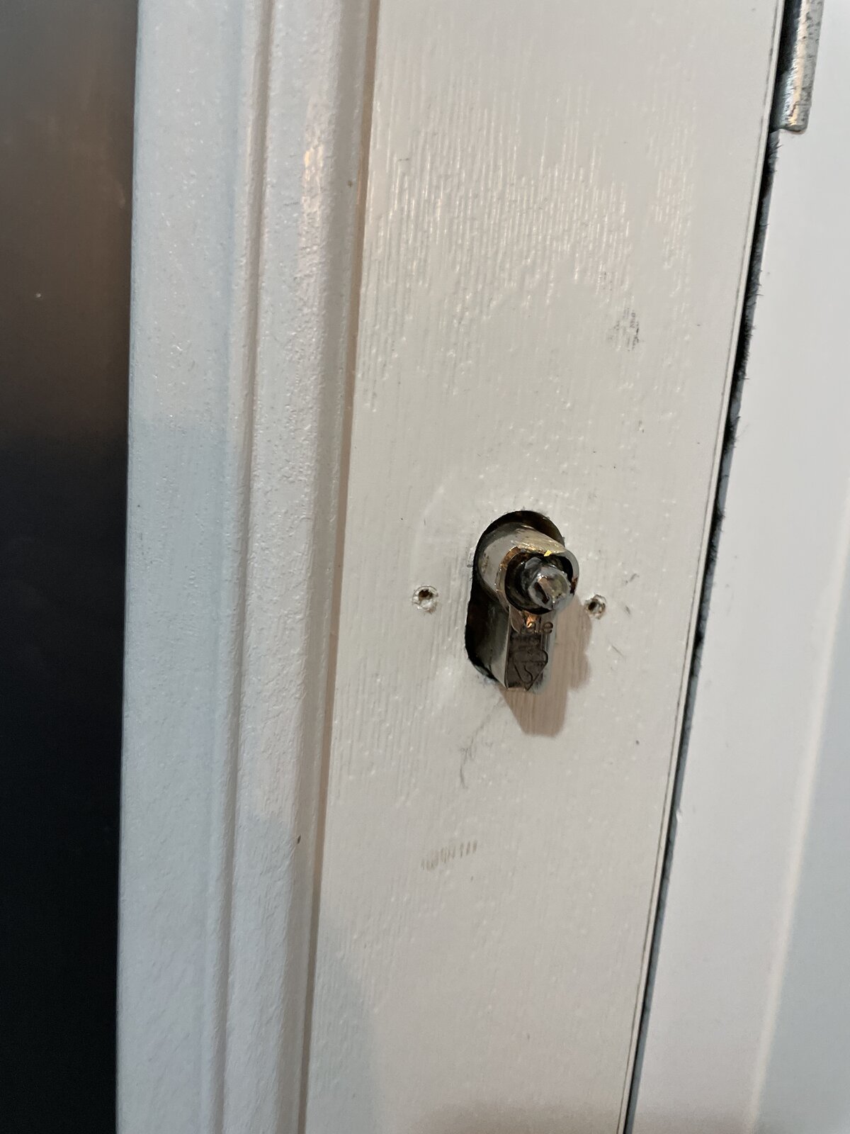

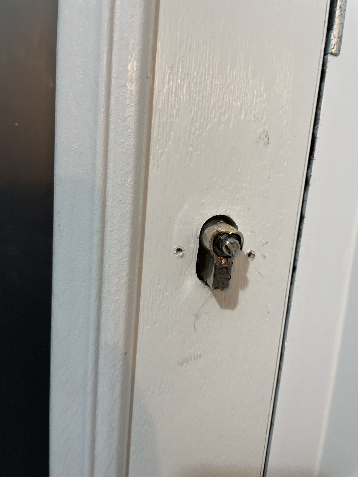

Thanks door is straight and not bent, photos inside with escutcheon off

It doesn't look like a bolt-through escutcheon or handle.
Thumb turn so no handle. I can drill from the front quite easy, just wonder how tough the pins on these locks

Just a good look from the front and it has a bolt thru escutcheon which is accessed with the cylinder removed. Am I right in the ****e now ‍♂️ as I cannot drill the lock.

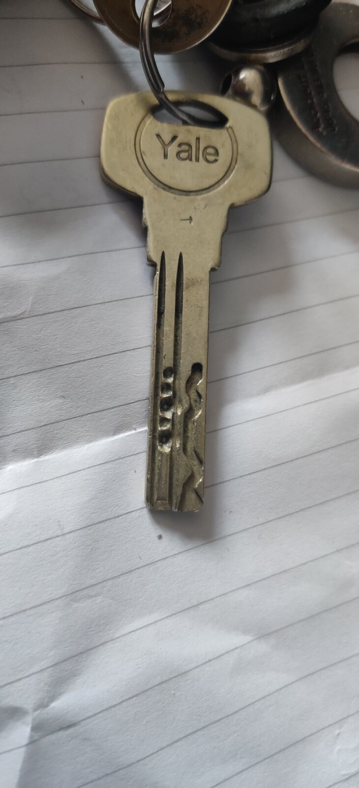

I've drilled many locks Yale style night latches/rim locks even with hardened pins protecting the tumblers, you just need cobalt bits, normal HSS bits will just bounce off but that's for the common type Yale style front door key, however if your Yale key looks like this....
....then your in trouble.
Like I said if you have a key then drilling won't achieve anything - the barrel still won't turn for some reason, even the thumb turn doesn't turn.
