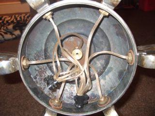

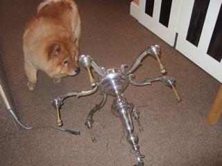

I have just bought a French antique (1920.s) light fitting (metal.) It's clearly been rewired recently with 1mm cable however being French there's no Earth cable. Should I add an earth: if so what's the best way??

Are you able to post some 'pictures' of the light ?'

Edited - posted before I saw your picture, comments above are for a table lamp. for that unit I would drill a hole in the ceiling rose.
Hi,
Maybe an 'eyelet' crimp lug, and lock nut/washer on the 'arm' top left of the pic ????
