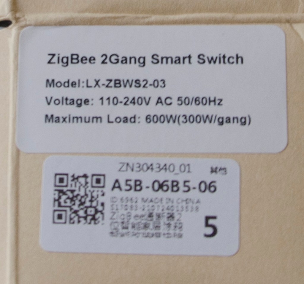

The relay in the loft space. Landing-light-relay-instructions2.jpgLanding-light-relay-instructions2.jpgI have included the instructions, I wanted a low light to go to the bathroom at night, but good lighting at other times, so I fitted a relay.
The centre bulb DSC_6799.jpg is on the switch, the outer bulbs use phone app or google mini to turn on, so simple "hey google turn on landing lights" gets all, and "hey google turn on switch inner" gets just centre, or "hey google turn on switch outer" gets just outer lights.
Been running now for around 9 months, and very pleased with it, I do now wish the relay had been put outside the fitting so I could easy change it, but that's hind sight.

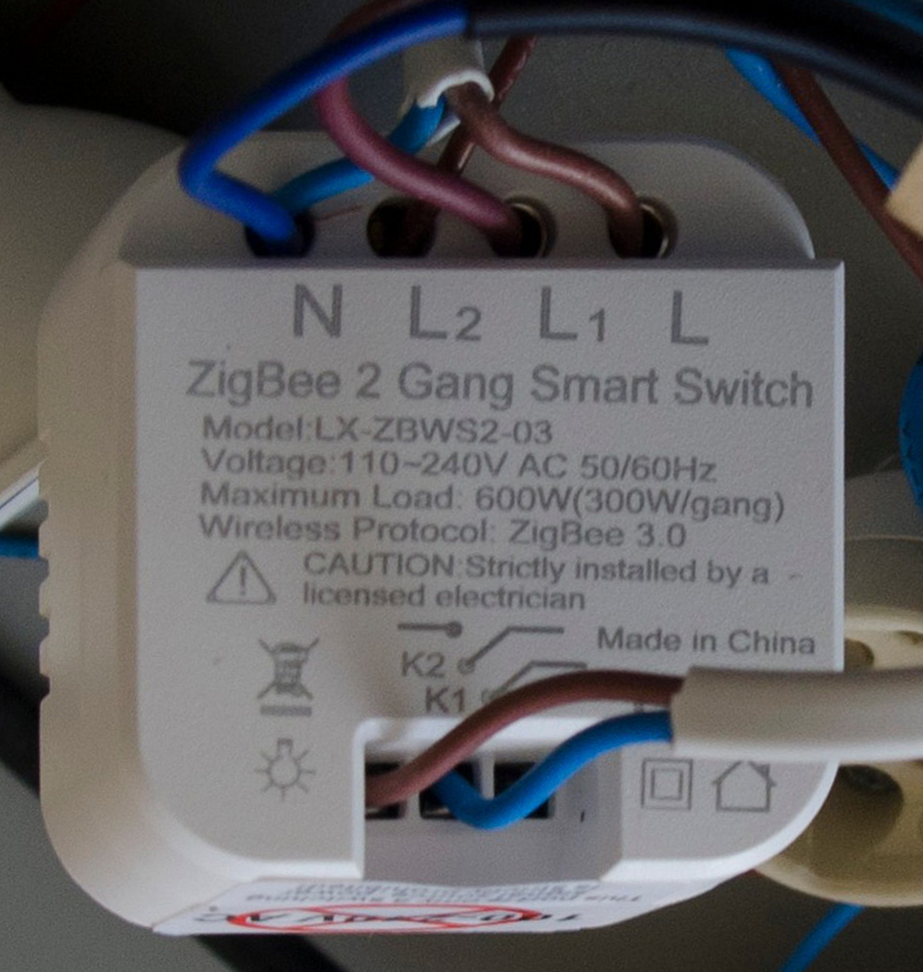

As a P.S. details on box DSC_6060.jpg but any smart lights will do the same, the question is the default state, power cut leaves relay off, also leaves wall light switches off, but my smart bulbs default on, I am told some like Philips Hue you can set the default, I got a three GU10 light bar from Lidi with three smart bulbs and a remote control, the remote has holes in back which allow wall mounting.
The kinetic switch also does not need wires, basic same idea as my relay, and I am sure many others.
