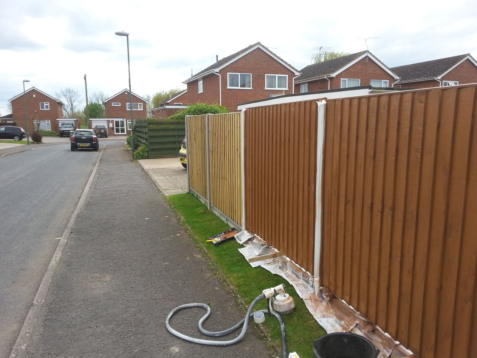

You can use a cheap hvlp around £80. I used duck back. I can do 13 panels with 2 coats in a day at an easy pace. Prepare ahead and tidy behind. Use a small roller and brush to snag up.

No I never.
It's got a thixotropic agent in so a good stir thins it. Run through vegetable net and spray. Will splatter a bit but dries fine. Just get it on. Lash it on tbh.
Really don't need to atomize it as your not looking for a flawless finish.
Edit. Thinking about it I did add a splash of water. Not much. About 5%
Was way thicker than recommend and would not go through the ford viscosity cup
This is why I am thinking a good airless may be better on thicker paints.
Now water based so thinning is easier.
