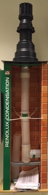

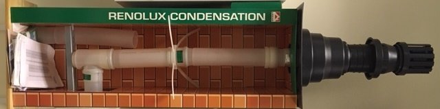

Here is a picture of the flexible liner we use. This is shown as a room sealed kit but the evolve I know has an Open Flue configuration (B23), whether there's a kit for room sealed I'm not sure.
Best to contact [email protected] for confirmation. A full description of the job and pictures too if you have any would be helpful. I'm on the road this week so of limited help.
For reasons I don't understand the pic ships sideways, sorry about that.
