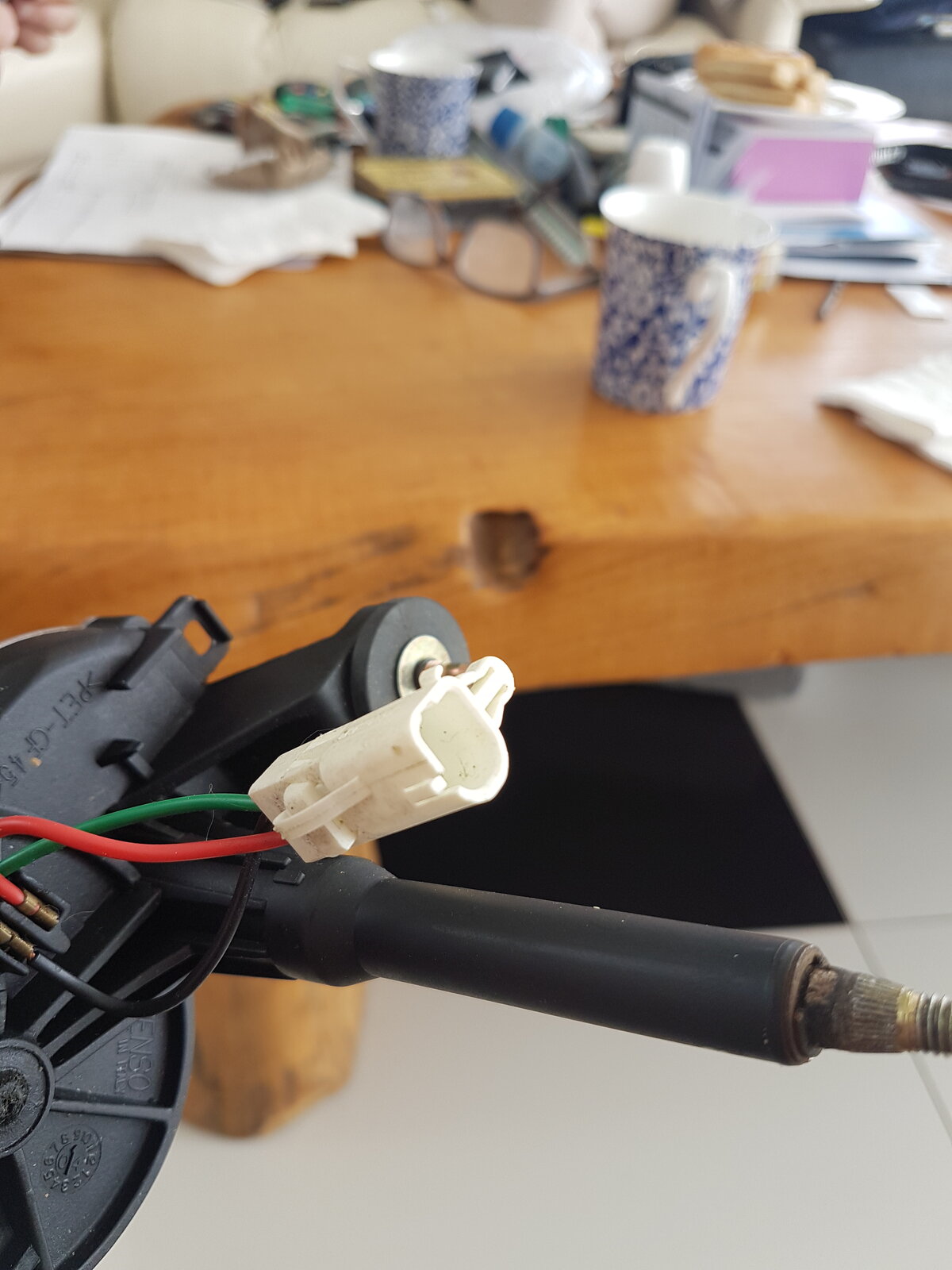

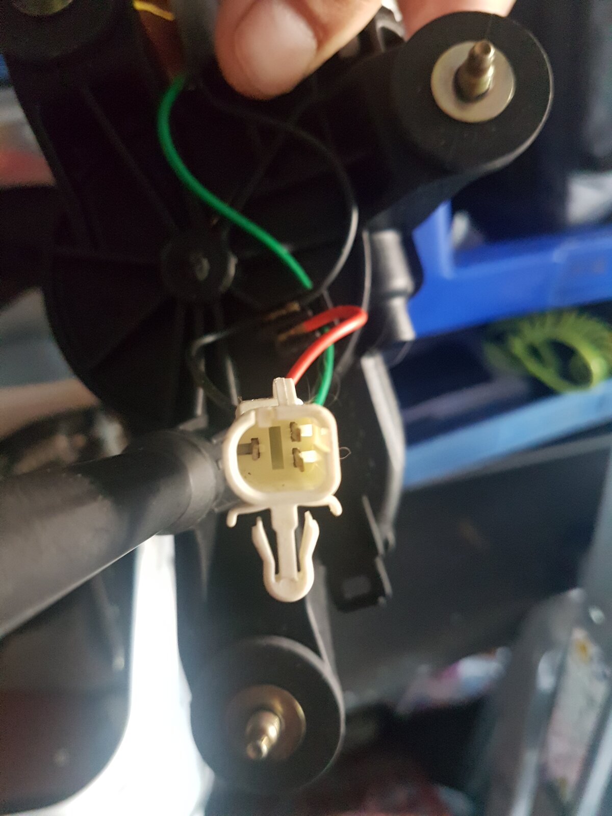

Any idea what this connector is?
28 Sep 2019
177
9
It's off a 2003 Fiat Punto wiper motor. Looking for the corresponding male part to insert in to connect the motor to a 12v leisure battery on a boat.

You could go to a scrappers and see if you could get a length of Fiat loom, or why not cut that connector off and sort your own?
vehiclewiringproducts.co.uk
Will be able to assist.
John :)
Yeah,g I could just snip it off and solder on my own connector.

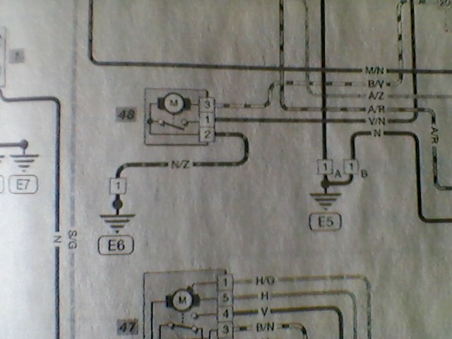

Any idea what the green wire would be? Wouldn't be an earth would it?
This for the rear wiper on the '99 to 2003 Punto model from the Haynes
3 - B/V white/green
1 - V/N green/black
2 - N/Z black/purple (ground)
full
Wiper motors have a self park mechanism, hence they can keep going even when switched off at the column switch, hence the 3 wires.
