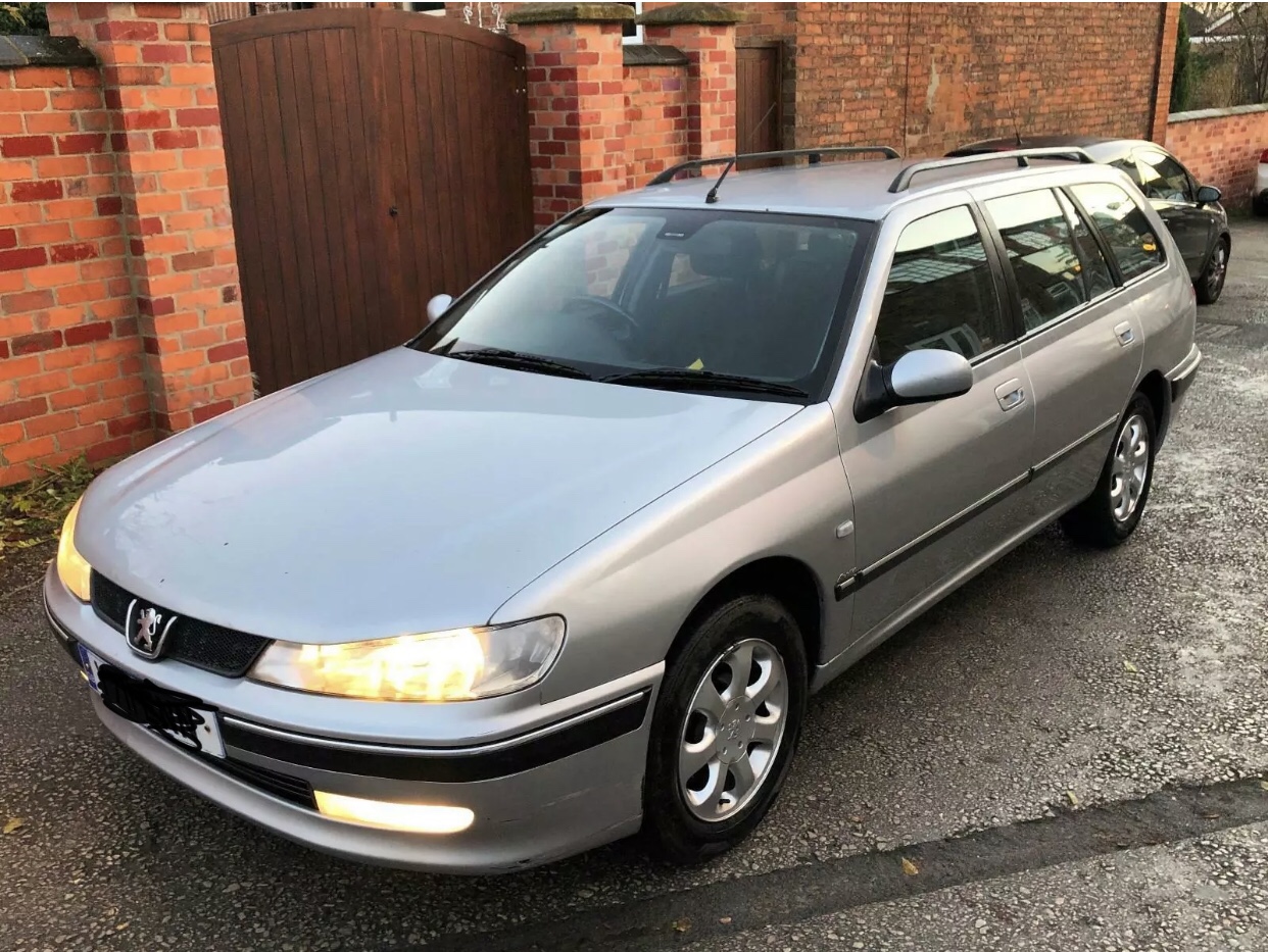

Any Peugeot 406 owners on here? I have abandoned 8 years of Ford ownership with their hit-or-miss TDCi engines to buy a 2.0 HDi.
The engine bay is refreshingly well laid out with most serviceable parts accessible to work on. It's done 153k but from talking to people in the owner's club before buying, they've said they're capable of many more miles than that. Easier than the Ford to start in cold weather and the fuel economy seems great (even with my heavier right foot, it being the 90 HP version!)
It has a few issues chiefly the fact that the car shudders/vibrates when pulling away in first gear -- presuming this is bottom engine mounts.

The juddering could be a clutch, maybe but do check the mounting at the bottom of the gearbox which connects to the bodyshell.

That Peugeot looks excellent! I seem to remember the rear suspension on the estate versions has drop links which are prone to wear but its been a long time since I've seen one.
The front springs are about 3' long :eek: but give a comfy ride. I think these have an Eloys fluid tank which needs replenishing at 80k.
Vibration could do with clutch/dmf wearing out.
Thanks, as burnerman says it could be the clutch or the mountings for the engine or gearbox. I've also heard the springs between the plates can wear. Luckily there is no DMF on this model!

Shuddering is likely the clutch, check engine mounts also.
aucth fork and this wears, causing aheavy clutch and lso the clucth fork and release bearing should be checked, they have a nylon pivot on the clutch fork and this wears out
