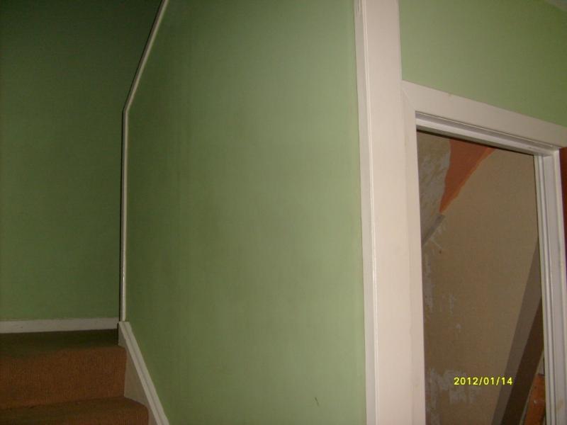

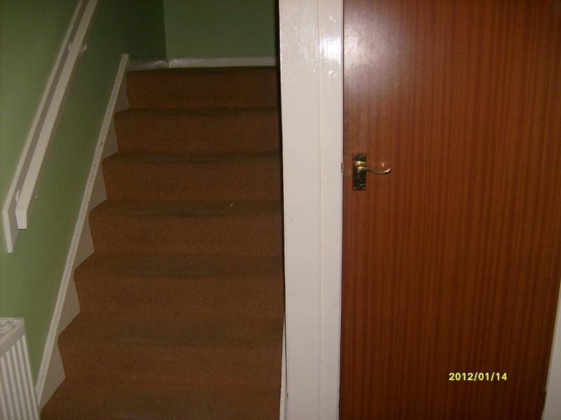

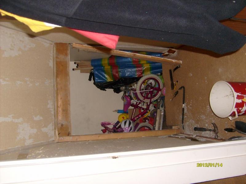

Here are some photos...
inside cupboard showing where the internal cupboard with doors was ...horizontal (vertical in this pic!) is joist support of half landing
