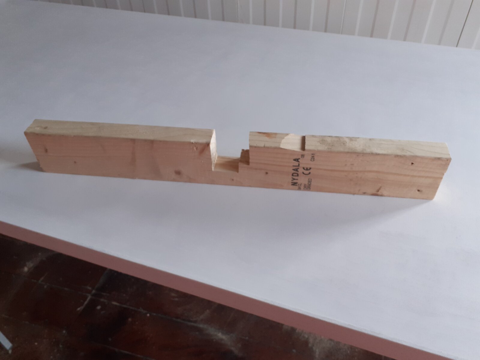

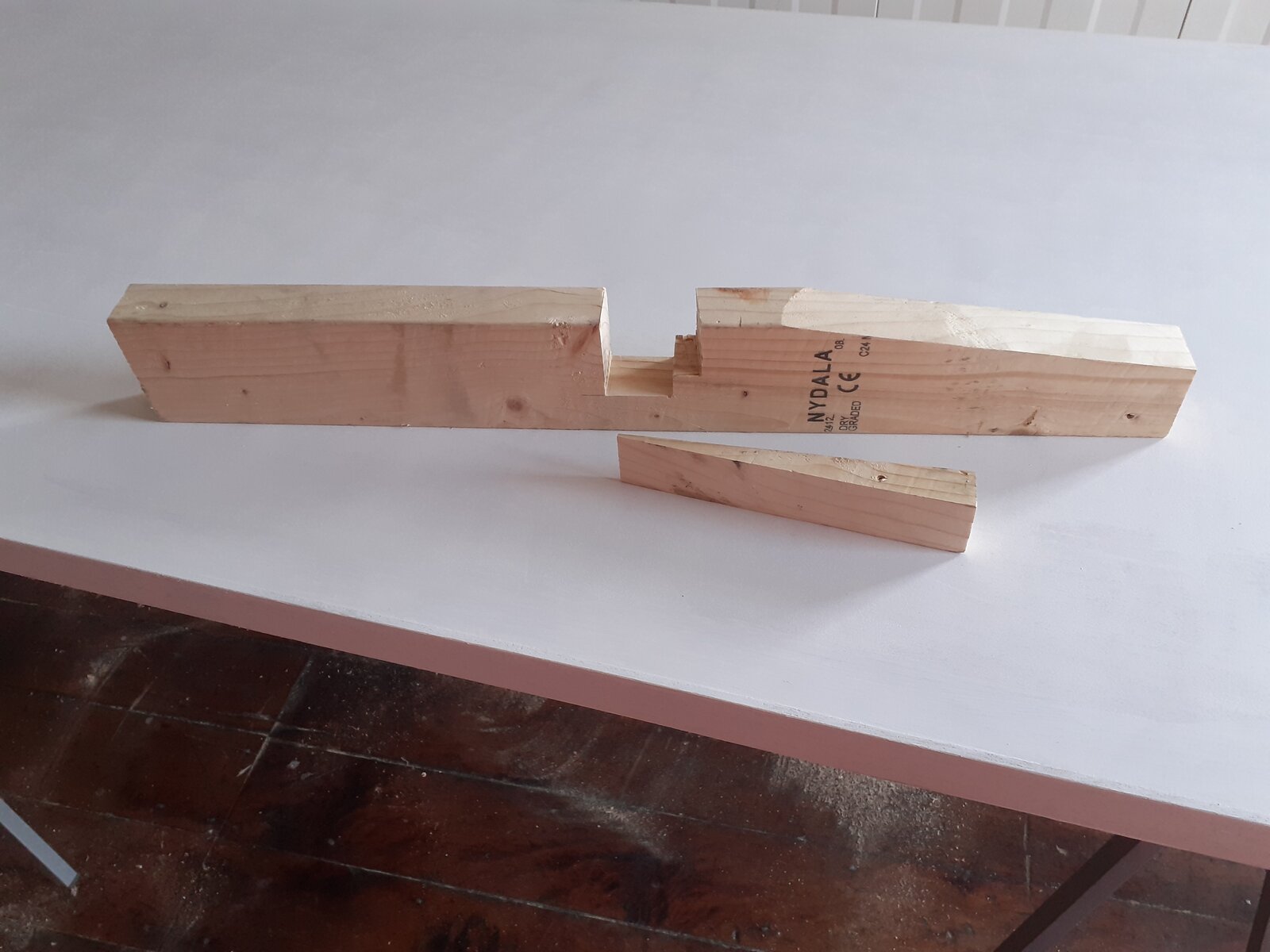

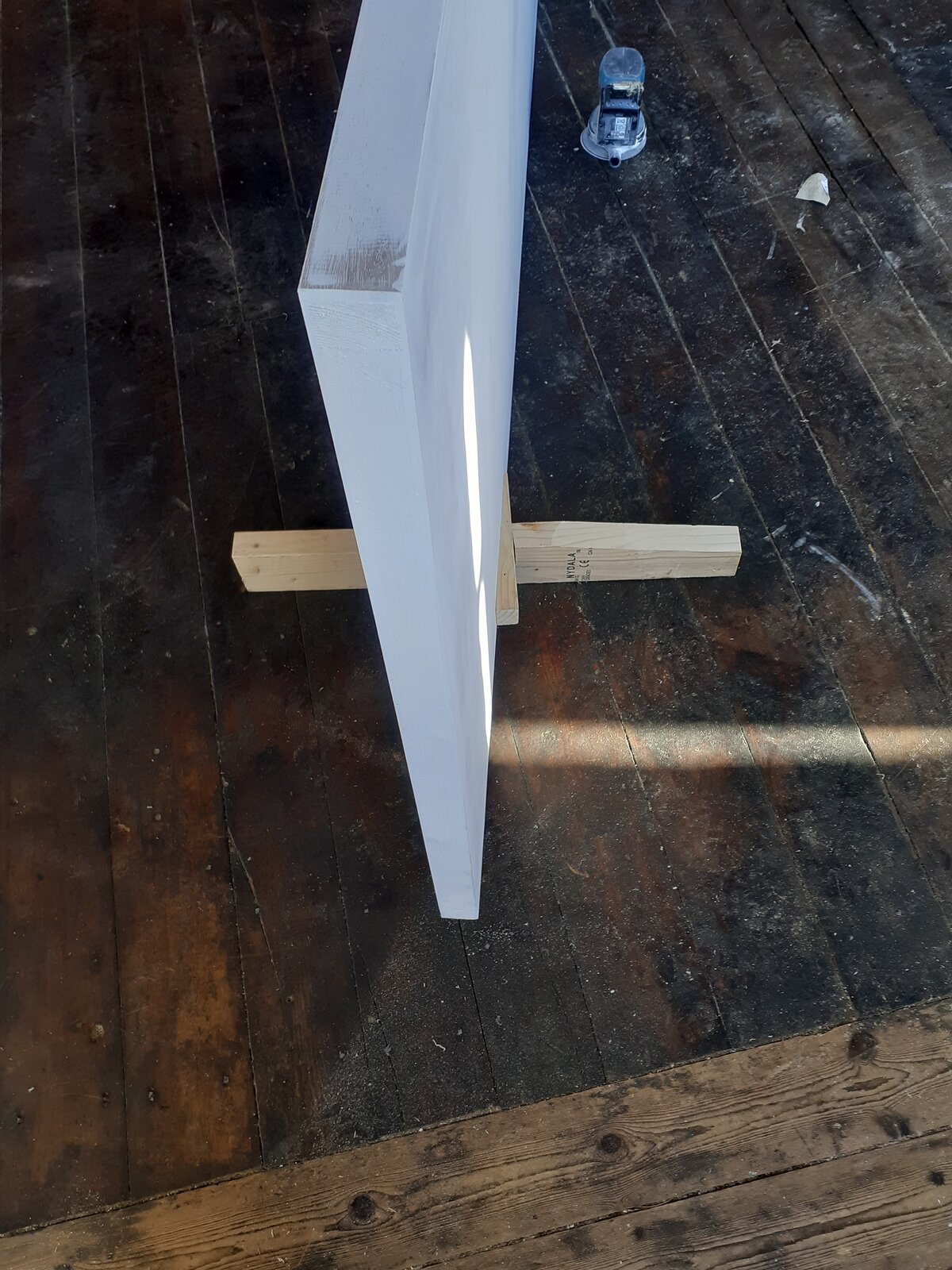

In order to shoot any door in you need a (home made) door block to hold the door, some 4mm plastic packers and a couple of cheap WinBags.
This is a door clamp:
Made from a single piece of 3 x 2 or 4 x 2 softwood. Here it is in use:
