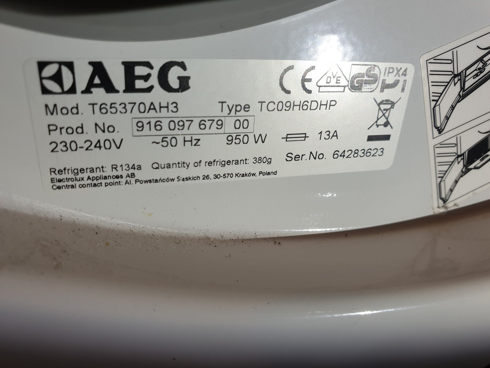

We have an AEG Protex Lavatherm tumble dryer. Only a couple of years old but hardly used. Everything works as it should but no heat being produced. No faults or warning lights on now although my wife thinks she saw all three lights on last time she emptied it - filter, water tray and condenser. Could it be the heating element? Worth fixing or should I just cut my losses and buy a new one? Tried unplugging it and leaving for a while as I read online this is how to reset it. Anything to test inside? Any and all suggestions welcome. :)

No heating element in that one, it has a heat pump or basically a refrigeration unit inside. Quantity of refigerant on the label would indicate that.

Ah, right. So there will be no cut-outs on it anywhere? I’ve watched a couple of tutorials online so I might have a poke around tomorrow night and test whatever I can, up to the limits of my limited capabilities! If no luck, I’ll replace it. Reading up on them, those with a heat pump are more economical but take much longer to dry clothes which is fine if you use it frequently. I've just asked the wife and according to her, it’s only used for drying clothes 'in an emergency' (so in our case, never!) but mainly it’s used just a couple of times a month, if that, to 'fluff up' the towels. It’s in an outside shed so I might just change it for a vented type as I’ve just read that you shouldn’t have a condenser or heat pump dryer in an unheated outside building. I suppose that’s because any water/condensation inside could freeze and damage something?
Update. I couldn’t get my lazy arse in gear so to get the wife off my back, I ordered a basic vented tumble dryer last night from Appliances online and it came at 8.00 this morning! After reading up, heat pump and/or condenser dryers shouldn’t be used in outbuildings where temperatures can fall below 5°C so even if I could get it fixed, it’s pointless. Bloody thing took ages to dry stuff anyway. Just gotta finish my coffee and get off the internet and go out and fit it in the shed........
2nd update: Indoors, it works! I cleaned the filter properly (wife said she had but it needs thorough cleaning after every use apparently:mad:), put a damp towel in it, switched on and off it went, working perfect. Oh well, I’ll offer it to family and friends and if no takers it will go to a local charity.
