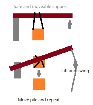

Sketch not to scale. The closer the sack is to the pile then less effort required at end of beam
Takes time as it may only be possible to move the sack a foot or so each lift.
