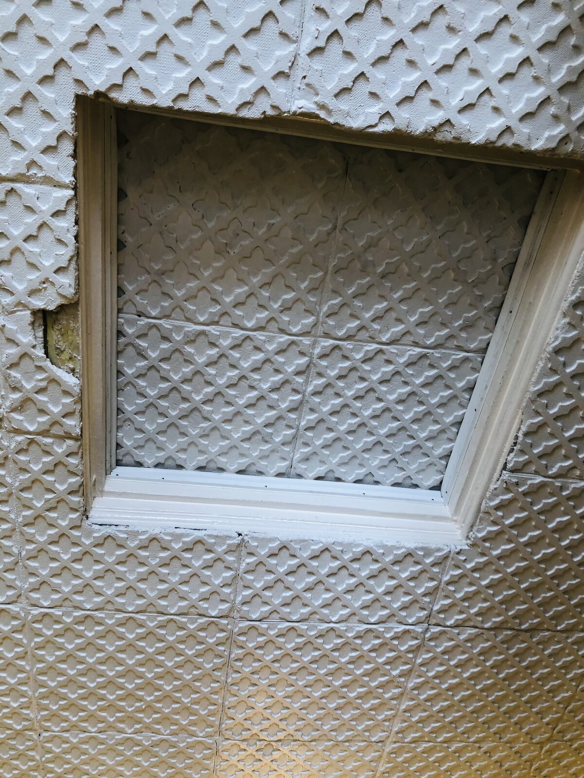

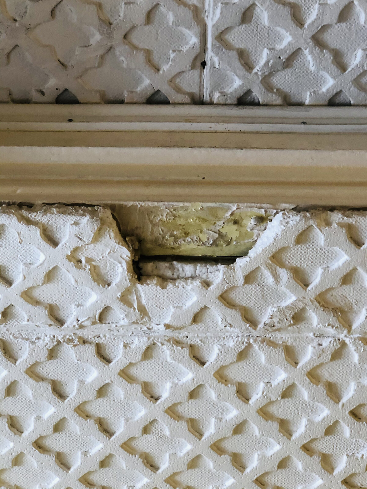

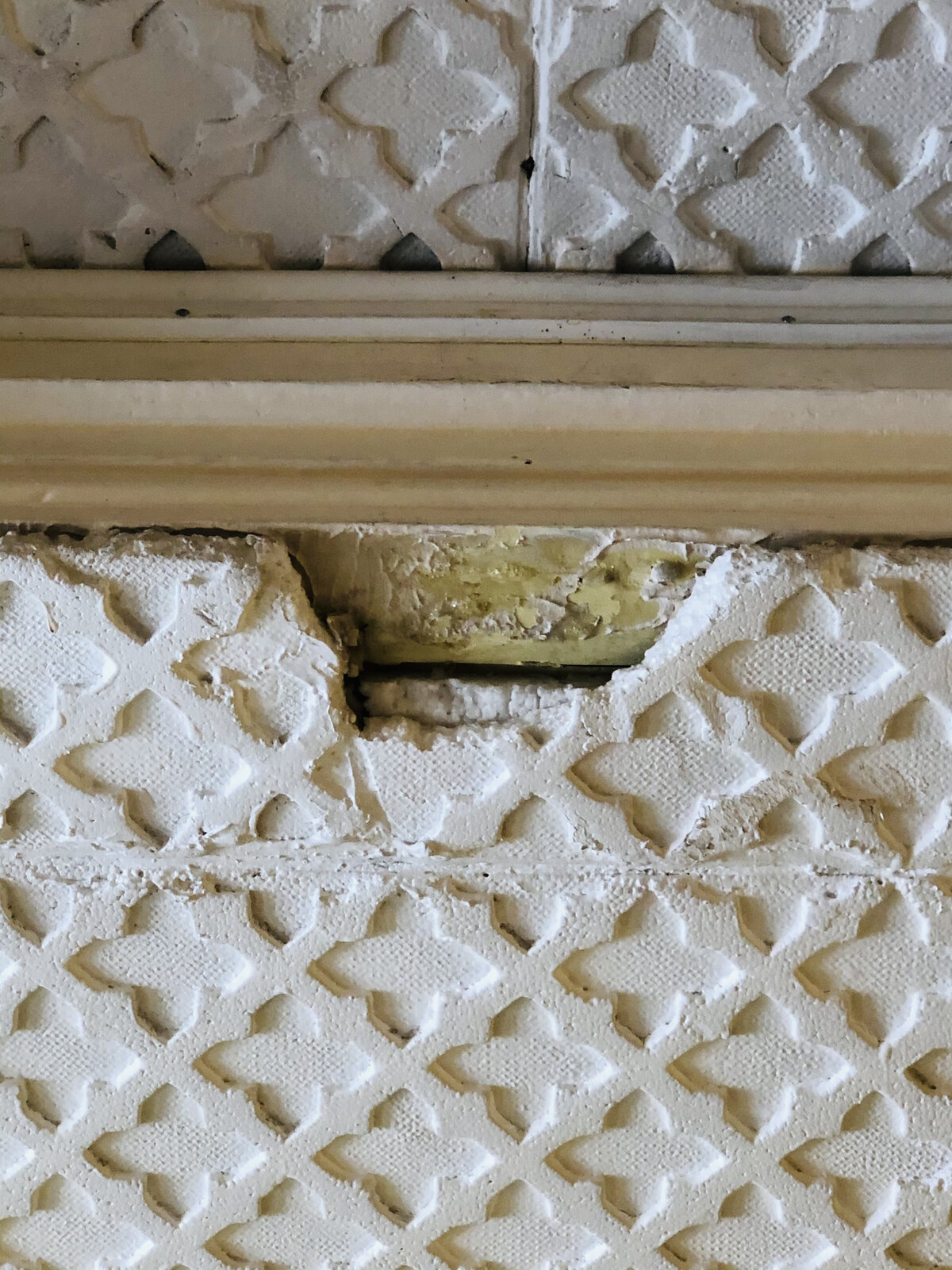

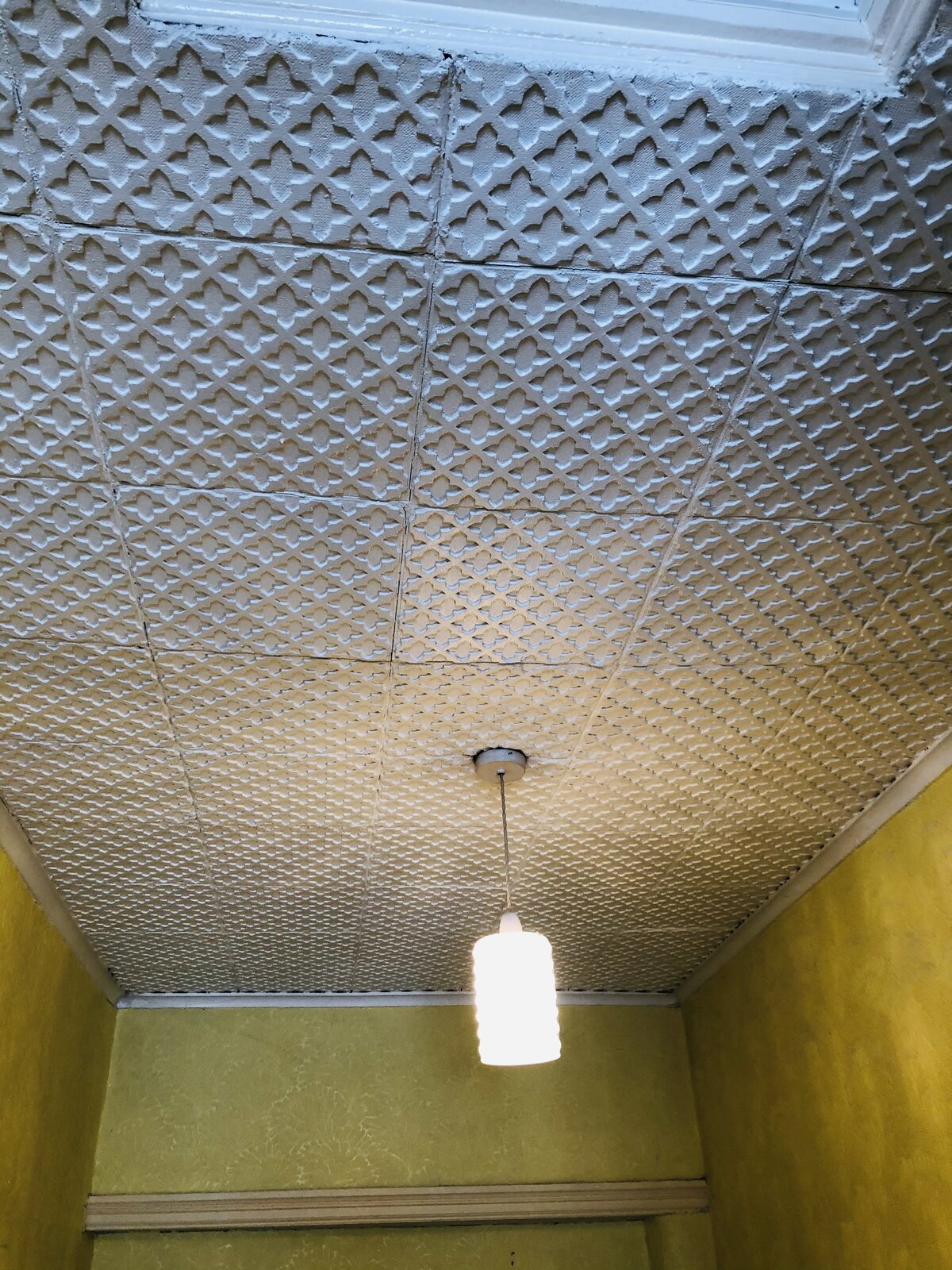

Hi there,
looking to put an offer in on a Victorian property that requires a full refurb. The whole upstairs ceiling is covered in these tiles, there’s no way to do an asbestos test until a survey but any way to tell if these are going to be problematic? The look like polystyrene up close but I’m guessing from the style they were fitted quite a while ago- possibly in the 70s(?)

Probably polystyrene
Heat a metal tool like a screwdriver/ pallet knife over a gas ring and push it into a tile.
If it melts, it’s polystyrene - don’t breathe in any fumes.
I have never heard of polystyrene / asbestos mix tiles.
If in doubt send away a sample for testing.
if they are polystyrene you can strip them off and leave the adhesive as a lump on the ceiling, a hot air stripper and scraper will get it off cleanly. The ceiling might be damaged - hence the tiles
Yeah. Put a match to it but not inside
Asbestos don't burn however polystyrene will turn to liquid and vapour is toxic so consider this.
99% sure that's polystyrene though.
Will float in water and feel warm to the touch if polystyrene.
Think everyone knows what polystyrene is so ask someone if you don't
I would say polystyrene. My parents used them a lot.
Several rooms here had polystyrene tiles which were stuck on with wallpaper paste.
If they fell very warm if you press your hand against them and they easily dent under knuckle pressure then more than likely poly. Another way to test, if you put them in contact with cellulose thinners or nail varnish they dissolve .
