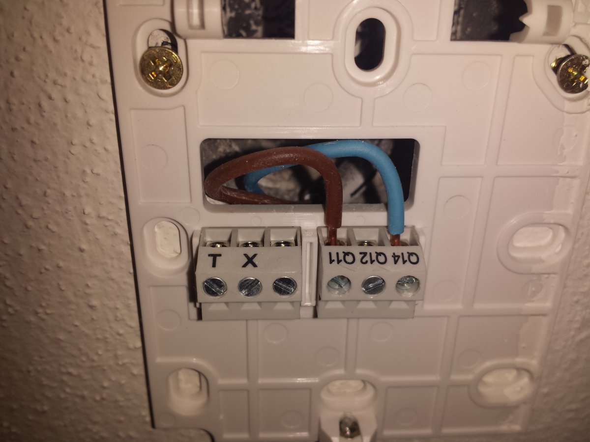

Hello everyone :)
I want to install the ecobee in my apartment and like most Europeans installation i saw i only have 2 wires coming in. Those wires are marked as Q11 and Q14 respectively.
A photo of the wiring is attached and the manual for my current thermostat is here (model RDE100.1 )
I will have a voltage meter available tomorrow to verify what i am feeding to the thermostat.
Do you have recommendation on how to install the ecobee? i want to make sure i fully understand what i need to do.
thanks

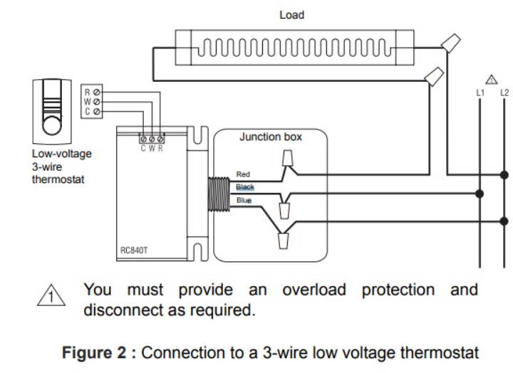

I know this is an old post, but I'm trying to do exactly the same thing, and my electrician has given up trying to get this arrangement to work, so looking for some help. I ended up buying an Aube Technologies RC840T to facilitate this, but reading wcavanagh's comment suggests it should be easier than this, and I can see that you're still active on here, so was dearly hoping you could share a simple wiring diagram using the 24v relay you shared above? Big thanks in advance!
Hi @wcavanagh, same here, I sent you a message last week. I would appreciate any help.
Many thanks in advance! :)
Ok, got this working......
You need one of these:
https://www.amazon.co.uk/Technologies-RC840T-240-Switching-Electric-Transformer/dp/B0037MXM1C?th=1
Wired like this:
R, W & C to the EcoBee are fairly self explanantory (Ignore the PEK wire, not required):
On the boiler side, in my case a Worcester Bosch, red to the switched load (LR) (radiator symbol), Blue to (N)eutral (OUT) and Black to (L)ive (OUT) ------ (Ignore the wiring in the photo below, this was prior to install with the old thermostat still in situ whilst figuring this all out)
I know an electrician based out of Stoke who now knows how to install low voltage thermostats with 240v controlled boilers in this manner. He also knows how to install Lightwave Smart switches since working on this project, if you need help with this also
I hope this helps, it's taken me over a year to get to this point!!
