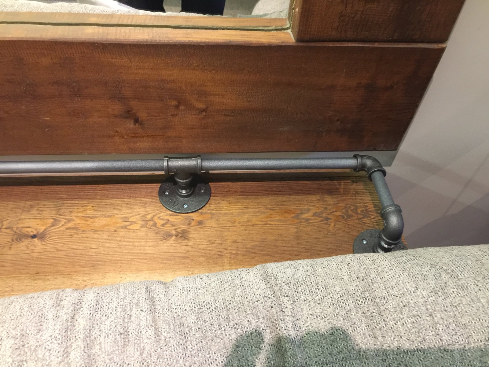

Anyone know source for the metal work on these shelf units
Thanks, needs to be smaller as will be too heavy.
I could use copper but can't find any plate fixing which would allow me to replicate a similar look.
It looks like the steel pipes used in gas/heating in public buildings?
We have a few handrails at work that seem to have been made from steel/iron pipe and fittings.
It isn't keyclamp
Found some 1/2” which looks ok, used wood dowel sprayed to match as its decorative.
Excellent idea with the dowel - saved all the hassle of threading pipe - that comes in 6m. lengths. I did something similar with 1 +1/4" fittings and plain steel pipe araldite 'd into the fittings . Then I have squash balls in the open ends of the fittings ( 4 off ) and my record deck sits on the balls - the pipework sits in holes core drilled into a wall - infinitely adjustable by screwing the balls in/out. No vibration reaches the deck;)
