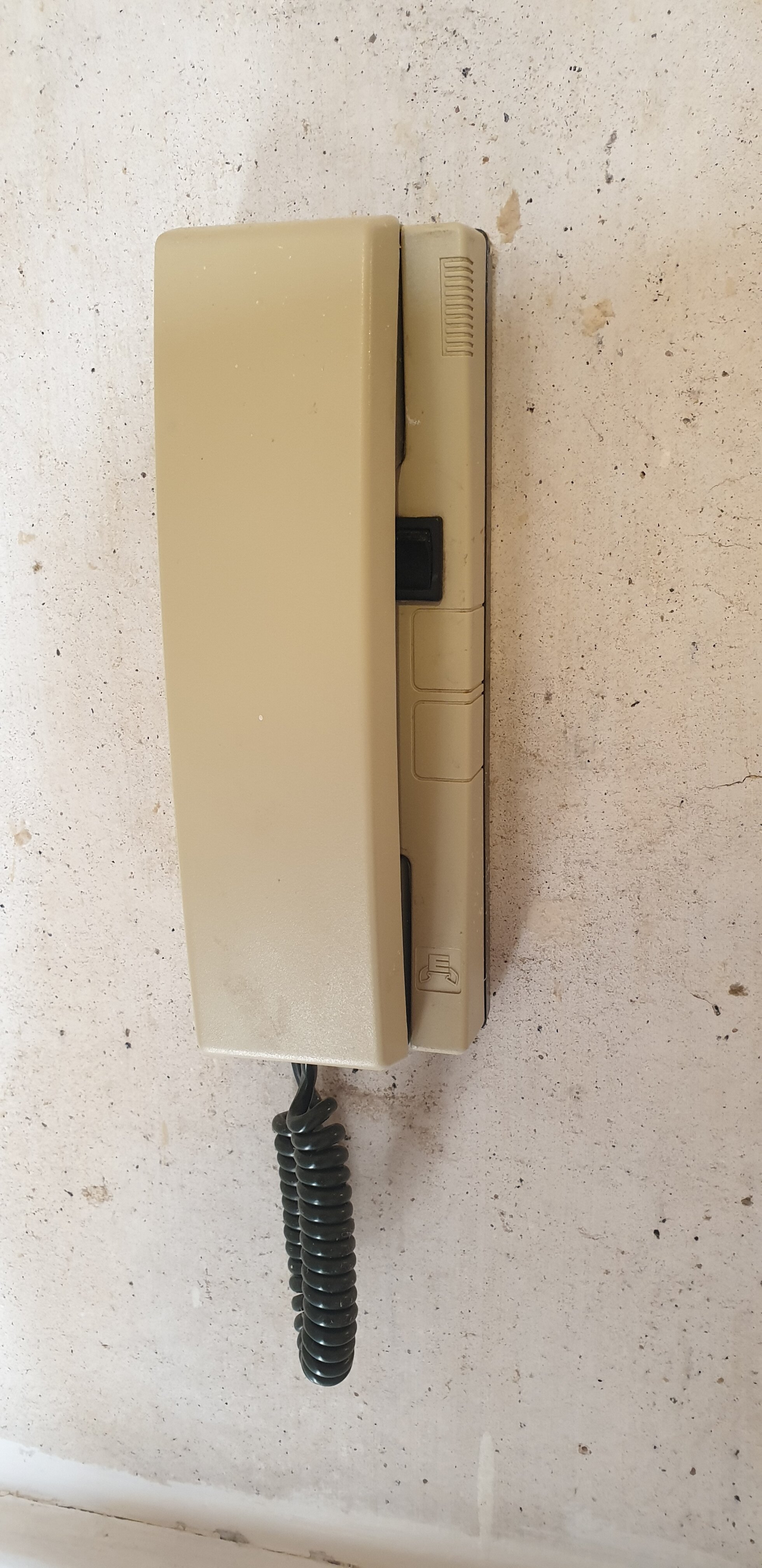

Anyone recognise this door intercom phone?
22 Sep 2010
255
3
Glasgow

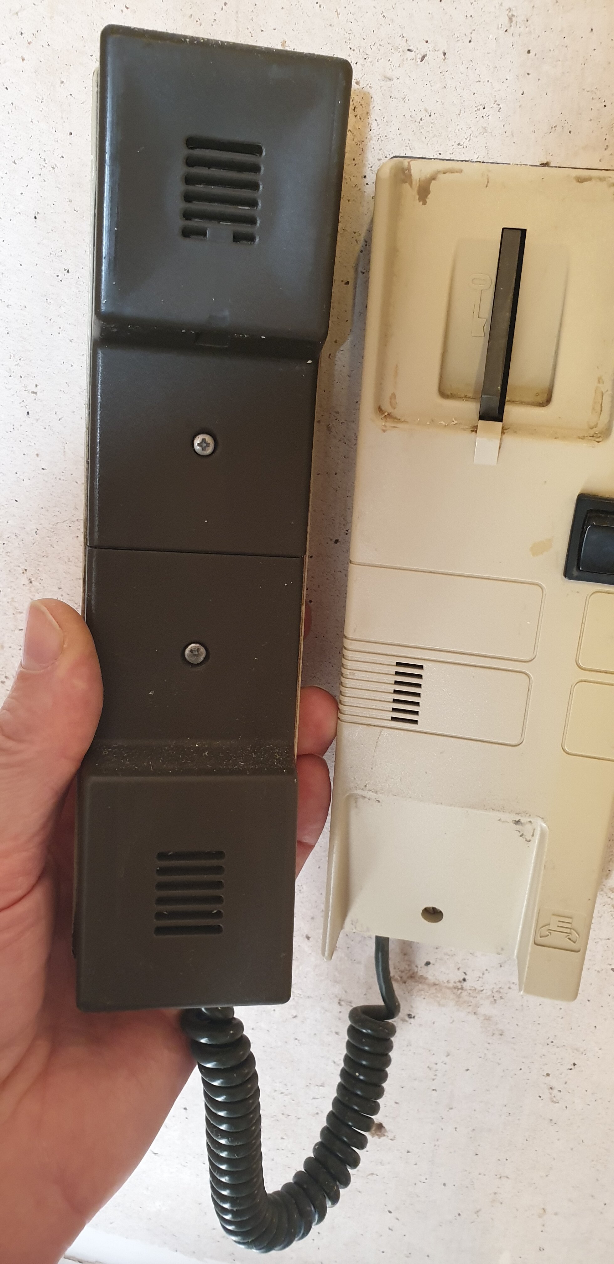

Looking to replace the below device, but there are no obvious model Ids on it, but possibly the brand logo is a capital E on top of a handset (bottom R of first image):
I am reluctant to fully take the thing off the wall at this stage, as the wires are very short and would all need to be disconnected to allow it. This might make it difficult to reconnect :confused:

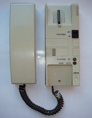

Looks like a STATUS. Lots of them were installed in council properties. The logo bottom right that has a handset through the E is the clue. There are quite a few different models numbers though.
There's a handy website Intercoms R Us here, that might help you locate a replacement. Their Handset Finder has some STATUS handsets.
I think you are right - its either a STATUS or the URMET which look pretty similar. The only difference with mine is that it doesn't have green/red LEDs (which is presumably what the small connector block on some images is for? mine doesn't have them).
Am I right in thinking then any universal 12V AC handset would do? IntercomsRUS have an Urmet 1130/11 which looks like the recognised replacement but it's quite expensive and a duff cream colour (am wanting white and more modern looking, and half the price).
