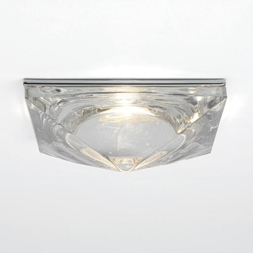

I have 4 of these lights in my bathroom.
They were installed 5 years ago and are connected to a single driver. There is no dimmer in circuit, and each is fitted with an mr16 12v 5w LED lamp.
Yesterday, after being switched on for a few seconds, they started to flash on and off at half second intervals. I removed the lamps one at a time in case there was a fault with one of them that was pulling too much current, but it didn't resolve anything the remaining lamps continued to flash. So I assume now that the driver is at fault.

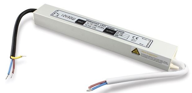

Thanks Lectrician, I like the spec and flexibility (0-50W) so will go with that.

That was my initial stance, it looks identical to the on in photo below, and has exactly the same spec. But as I'm not impressed with it failing after 5 years of light use (no pun intended) I have gone with Lectricians recommendation of the Varilight.

They are mr16's (GU5.3) I have the same ASTRO Pyramid lights in my kitchen which are 230V GU10's and 10 years old. When I wanted to buy them for the bathroom, about 5 years ago, I could only get 12v mr16's :(
