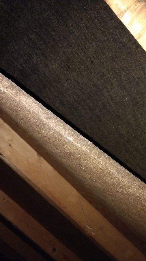

I know this is an old topic but I am now experiencing this issue also. I wonder how Dave-K got on. My house was built in 1984. My pal, a retired civil engineer, identified this as Celotex also, but when I contacted Celotex, thinking they must have experience of this issue, they were a bit cagey saying they weren't sure that this was their product - even though I had sent a link to this topic to them and mentioned my pal separately identifying it. Having said that, their most experienced guy (who I spoke to) only has 14 years service. His solution was to take the roof off and replace(!) - not really the route I wish to go down.
So, what to do? Well, for me, I think I'll try tackling the problem in two phases. First, I'll try to support the undamaged and least sagging ones before they start to sag and fall out. Then, secondly, put my thinking cap on again and try to come up with a solution to replace the ones which are basically write-offs. For "Phase 1," KenGMac's reply was very helpful but I'm not exactly sure how the battens should be attached. I had previously tried attaching a simple strip of wood to 'increase' the width of the rafter but I'm not sure how effective that is because the board is still sagging. Maybe I never pushed the board in back far enough (not straightforward, or even possible, with some of the boards) or perhaps the batten wasn't thick enough. So my next idea was to try to install some kind of support that will give both lateral and longitudinal support.
I have now installed a dozen diagonal wooden support battens to see how this works. This unfortunately involved a bit of preparation - cutting the ends at an angle and tailor fitting each support to fit between each pair of rafters (the gaps are not uniform) - but the actual installation was relatively easy. The two end off-cuts were then nailed to each rafter (usually only one nail but hole pre-drilled to prevent splitting) and then the support batten was slid in. By the way, I drilled another hole in the lower support block and inserted a wooden dowel to stop the diagonal support slipping down. Unfortunately, I don't know how to post photographs so hope this description is adequate.
It's quite an elegant looking solution and, so far, reasonably inexpensive. However, I've only tried this on the higher parts of the roof. The lower parts where it meets the walls will be a nightmare because of the restricted access. Has anyone else done anything on this since 2016 and what did you do? Also, what about those panels that are beyond fixing? Any ideas about replacing these?
