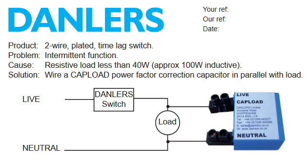

Found even with a 5 bulb chandelier the load was too low with 5 x G9 bulbs and it would flash when off, cured using load capacitor, load-capacitor.jpg and shimmer when on, in the end found larger bulbs which worked G9-comp.jpg can't get G9 smart bulbs yet.
