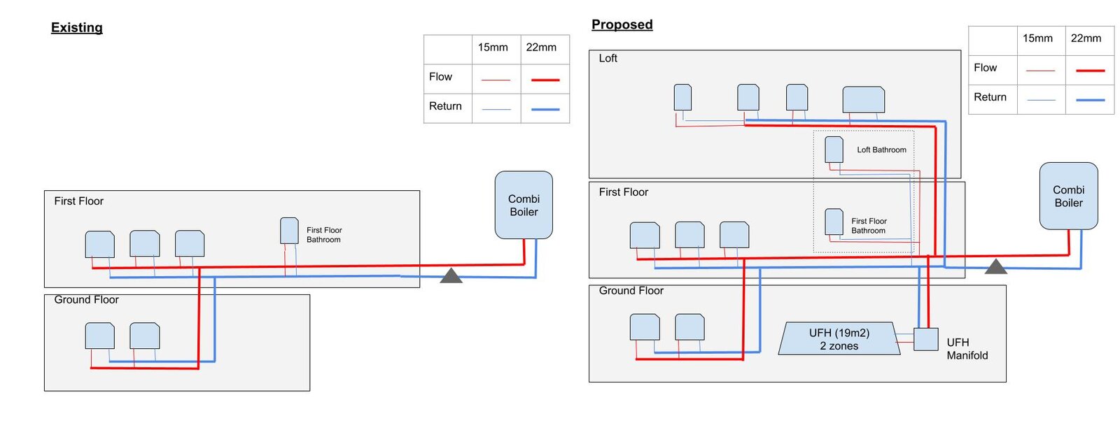

Small terraced house recently had loft installed and small side extension.
Originally the CH layout was quite simple, but I've been thinking about how to add the loft.
I was going to T off the 22mm flow and return to add the loft, put the bathrooms onto a seperate zone (so only this section runs in the summer) and add under floor heating.
Will the proposed design create problems with balancing?
TRVs will be fitting onto most of the rads, except for two bathrooms. Diagram shows thicker lines for 22mm. Grey triangle is magnetic filter.
32kw combi boiler.
Many thanks in advance.
