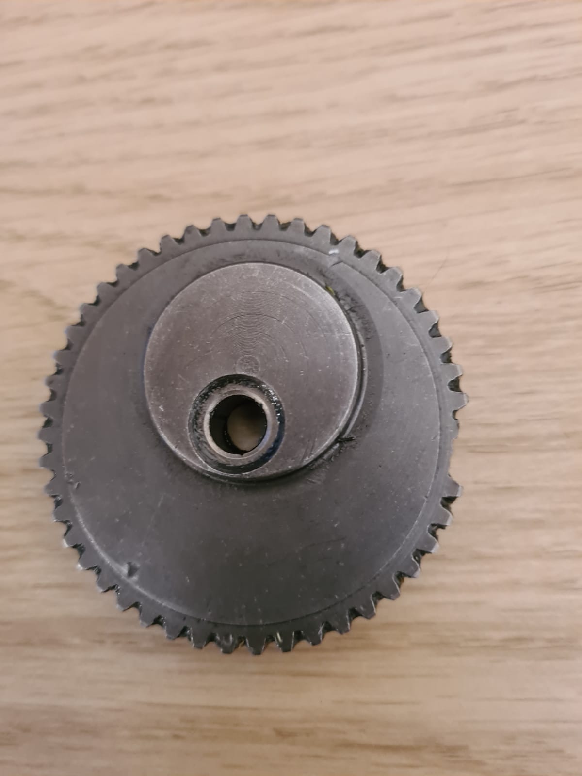

Anyway to mend this Hedge Trimmer gear teeth..?
21 Feb 2021
170
2
As you can see from images my hedge trimmer gear mechanism lost some teeth and no more working.!! This is from PARKSIDE (LIDL) branded 2-in -1 hedge trimmer /Pole Pruner. I mistakenly tried to cut metal rod!!
Any DIY way to mend this gear..? Some photos attached. Please help.
No way will you repair that gear wheel - the stresses on it are enormous so its a new gear wheel needed.
I guess the teeth sheared due to the cutter blades rusting together or jamming on a heavy branch.
Regular greasing in that area is vital.
John :)
Also bear in mind the damage done to that gear will have resulted in damage to the connecting gear.
Probably more economical to scrap the whole unit and buy a new one.
