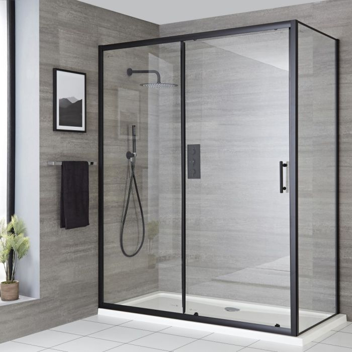

BS7671:2008 said:
walls with or without windows, doors, floors and fixed partitions may be taken into account where these effectively limit the extent of locations containing a bath or shower as well as their zones.
So it seems doors count but curtains don't! so is this shower.jpg a shower room, and outside the glass partition is not part of the bathroom assuming no bath? Since that would be likely what would be installed in a bedroom, that would mean no need for 3 meter rule in a bedroom, the shower is considered as being a separate room off the bedroom. But some how can't see the LABC agreeing with that, so if that shower cubical is not considered a room, neither is a cupboard in a bathroom with a washing machine in it considered as a separate room.
As said if safe, i.e. unlikely to get wet, and RCD protected then for owner occupied who cares, just do it, but if some one needs to inspect and write a report, not so sure, I was told off by LABC for not notifying them that a toilet and pantry had been turned into a wet room, seems it need notifying so would assume same in reverse, if you turn a space that was a bathroom into a room for some other use, they need notifying. In real terms I would only do it when they are going to find out anyway, however if I was renting a house with a washing machine in the bathroom I would not fit a plug and socket anywhere that could be considered a bathroom, unless no other option, and then even if never actually locked, I would put a lock on cupboard door.
I will be interested to see what others say, the main point is if they found it when doing an EICR would it get a code C2?

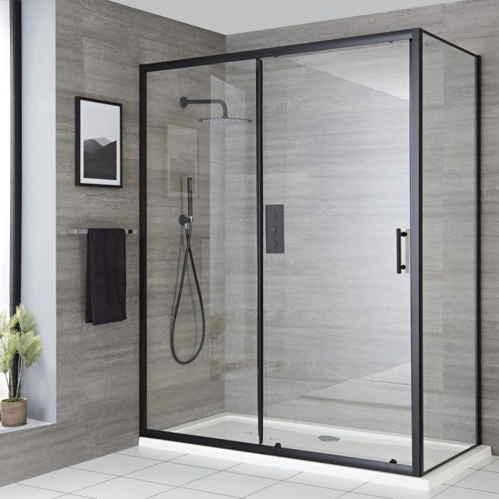

However it is the definition of a room, last house I had a dinning room and living room separated by an arch, no door, so clearly a door is not required to make it into a room, and the regulations don't refer to a room they refer to a location.
So it seems doors count but curtains don't! so is this View attachment 219603 a shower room, and outside the glass partition is not part of the bathroom assuming no bath? Since that would be likely what would be installed in a bedroom, that would mean no need for 3 meter rule in a bedroom, the shower is considered as being a separate room off the bedroom. But some how can't see the LABC agreeing with that, so if that shower cubical is not considered a room, neither is a cupboard in a bathroom with a washing machine in it considered as a separate room.
I think you've invented your own definition there. If it were a permanent (unclosable) opening between the two areas, I think that many/most people would call that a single room (e.g. "lounge-diner") and not two rooms.
By the same token, I do not think that one could sensibly argue that having some sort of partial partition containing a permanent opening could turn a bathroom into 'two rooms', such that a bath/shower on one side of the partition would not be 'in' the other part, so that 'other part' would have no restrictions in relation to electrical things 'in a room with bath or shower'.
As I recently wrote, I think we have to consider the (presumed) intent/spirit of the '3 metre rule', which is presumably intended to make it less likely that people will use a 'plugged in appliance' whilst in the bath or shower - and a partial partition with an opening would certainly not achieve that. As I recently wrote, it would even 'make some sense' for there to be a prohibition of sockets outside of a 'room containing a bath or shower' which were within 3m 'as the cable flies' of a bath or shower within the room.
