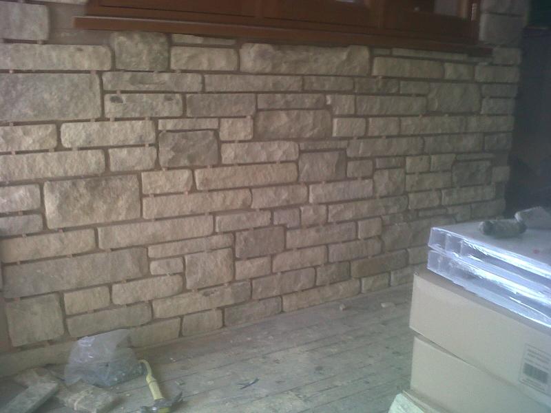

First one! Almost all done now!
Wasnt enough decent size stones to course it properly! So i just ended up doing it random! Not sure what you guys think? But i dont think its too bad for a 19 year old lol :D !
Show us a photo when it is pointed.

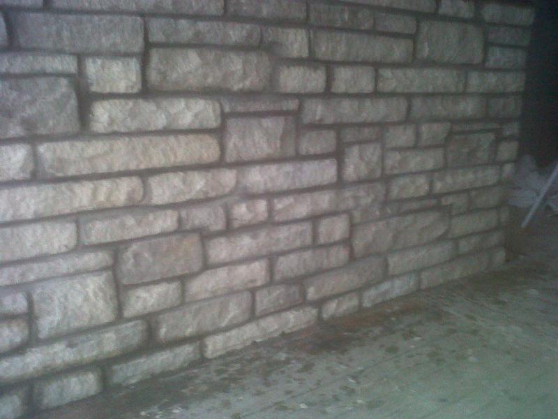

Will do, not starting the pointing as yet, but ill put one up when done!
Can i be curious and ask why? In terms of just what it looks like when finished or in terms of you'll think ill spoil it when i point it?
Cheers!
Hmm.. I must agree, What you think then?
Will take some pics of the full wall and bay and the rest of the showrrom at some point!
The pointing is flush as you can tell :eek:, many of the houses around the area are like that so kept it in keeping, not sure what you pro's think lol!
