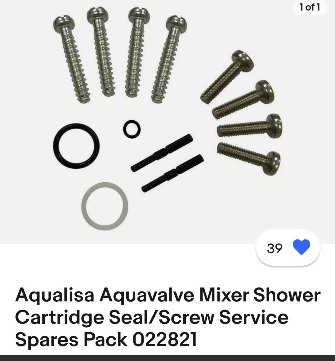

Aqualisa will only supply the two seals that are required when a new cartridge is fitted. These are the o ring at the back of the valve where the hot water enters and the bespoke seal/gasket between the cartridge and the body of the shower valve.

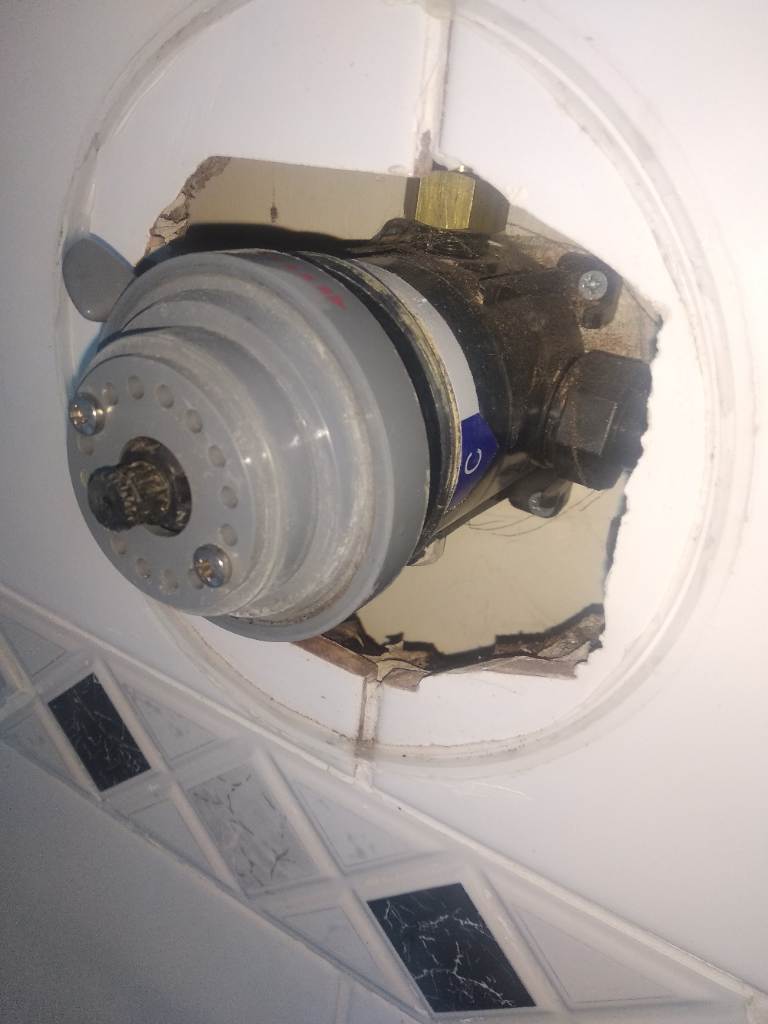

4) If you have the time and patience and want to have a go with the nitrile seals my experience is as follows:-
a. For leak 1) try replacing just the hot water o ring at the back of the valve. The size of this is Internal Diameter 14mm with a Cross Section of 2.5mm. This will cost around one pound.
b. If you do not have leak 3) and are careful you should be able to clean up and reuse the body gasket. (if you do have leak 3 you will probably need a new gasket either from Aqualisa direct or those on the web will almost certainly be Aqualisa supplied items)
c. If you still have a leak and want to replace the spindle o rings I have successfully used:-

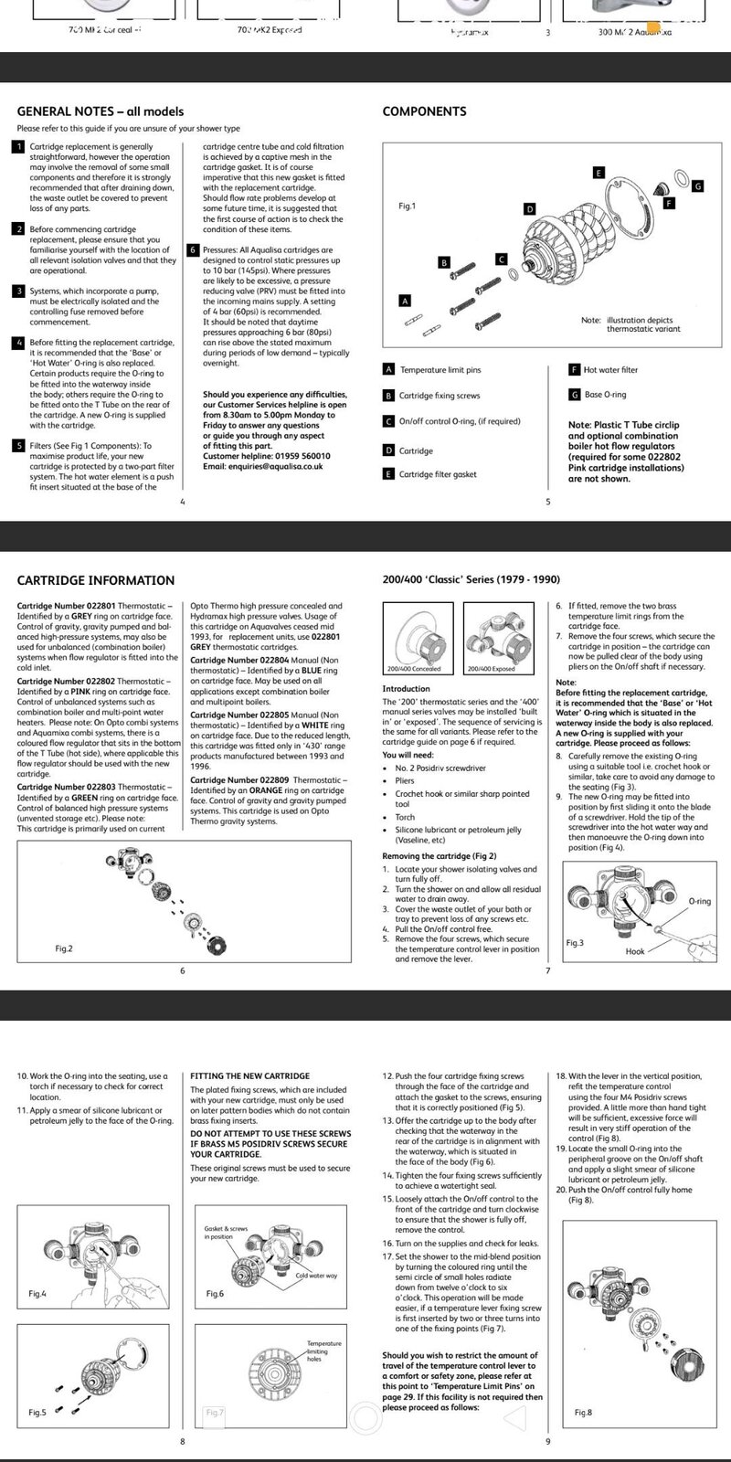

5) The precise instructions to gain access to the cartridge vary a little from model to model and are widely available on the web or by contacting Aqualisa.b. If you do not have leak 3) and are careful you should be able to clean up and reuse the body gasket. (if you do have leak 3 you will probably need a new gasket either from Aqualisa direct or those on the web will almost certainly be Aqualisa supplied items)
1 x ID 6mm x CS 2.5mm – nearest back
1 x ID 9mm x CS 1.5mm – the middle
1 x ID 8mm x CS 2.5mm – nearest front
1 x ID 14mm x CS 2.5mm – spindle cap o ring (same as for a. above)
d. These o rings can be purchased individually from various sources on Ebay for around a fiver in total.1 x ID 9mm x CS 1.5mm – the middle

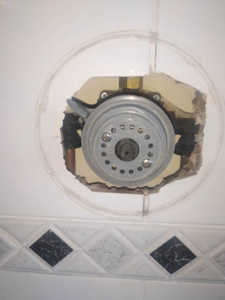

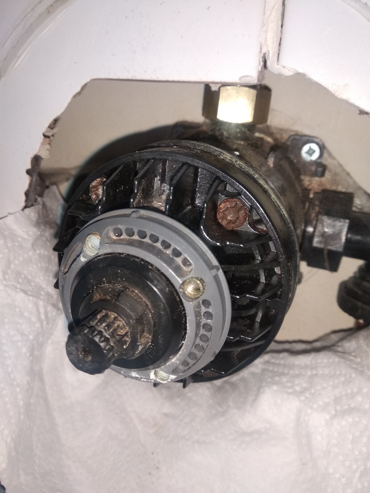

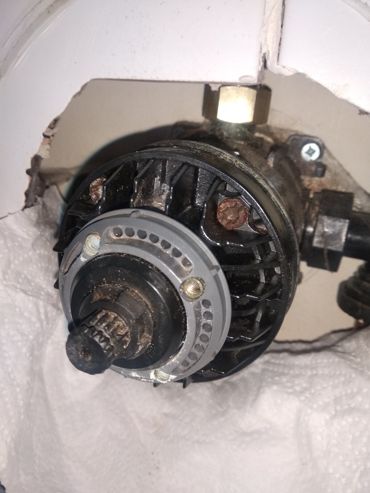

6) To dismantle the cartridge:-
a. Remove the lugged cap nut on the front of the cartridge. Use either long nose pliers or using great care, mole grips. It can be quite tight.
b. Note very carefully the position of the white washer and how it sits flush with its housing. Take a photo with the white washer on and also with the white washer removed.
c. Pull the shaft from the body again using great care. It can be tight since the internal o rings provide quite strong resistance. Putting the splined on/off knob back on and turning a little can help release the first o ring.
d. Carefully remove and replace the 4 o rings. 3 on the shaft and one on the screw cap. Silicone grease should be used – buy a tube if necessary for a couple of pounds – it is always useful to have.
e. When you reassemble it is essential to realise that there are two raised guides in the housing which must line up with the two small indents in the shaft collar just below the screw. These must locate first and the spindle will push in until there is a further resistance before the spindle is fully located. If the location is not correct pull the spindle out and start again. The final push can quite tight to overcome the resistance of the new cap o ring. It must push completely home before the cap nut is replaced. Use the photos at step b) to check. Replace the white washer and replace the cap using little more than hand tightness. The tightness of this cap is not part of the water seal – too much pressure will break the cap.
