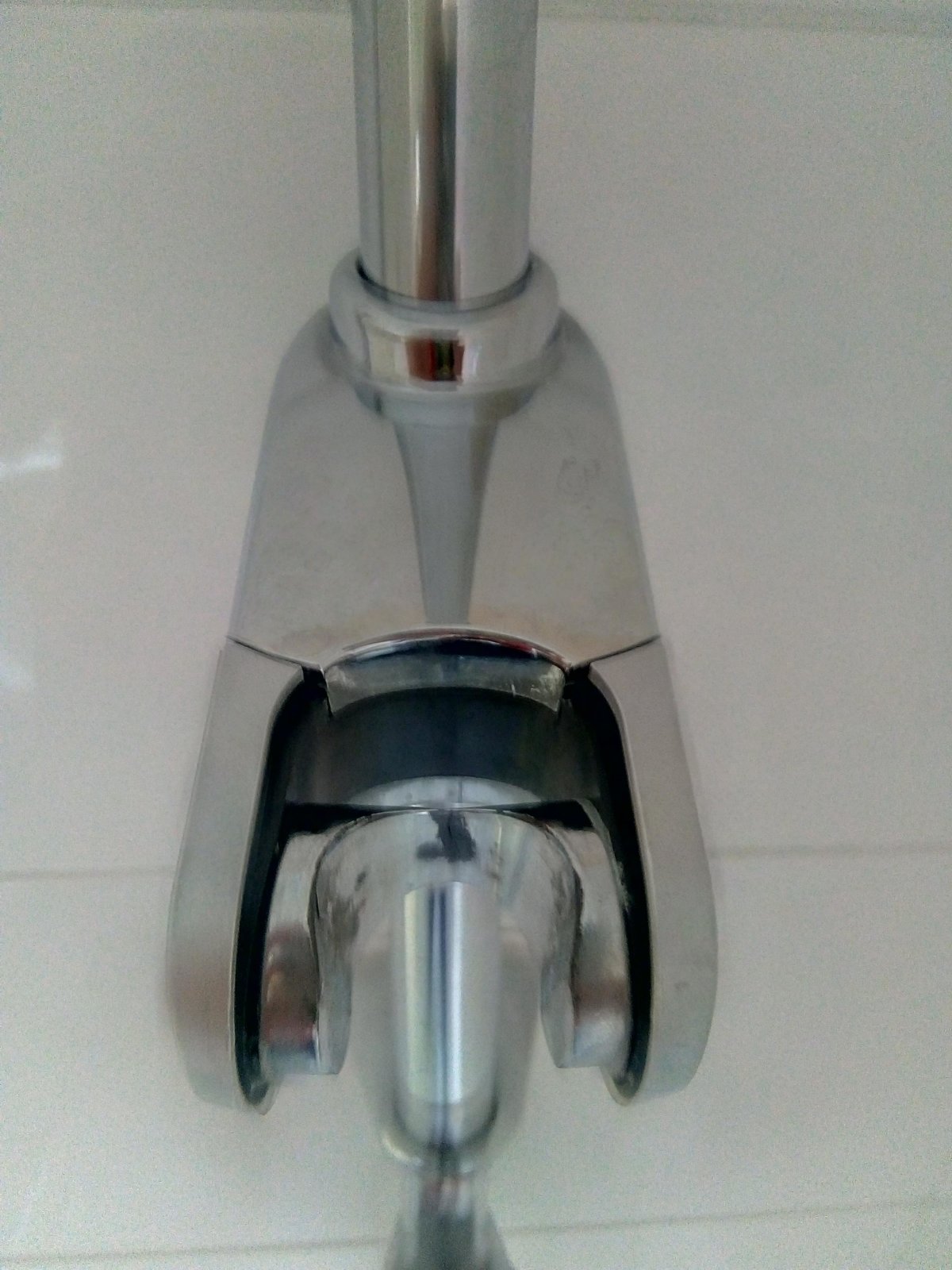

My tenants are complaining that the shower head holder is loose such that during a shower the head falls out of the holder.
It is of the Aqualisa pinch grip variety. The bit that grips the riser is fine. Just the side that the shower head slots into causes the shower head to be loose. The ratchet appears to be ok.
Have had a look and can't see anything wrong with it or signs of damage.
The part that the shower head slots into appears to be too big but there's no obvious signs of deformity. Plus I think (please confirm if you can?) that part looks fairly solid metal, so unlikely that it would have got stretched over time but if anyone has any experiences of this please let me know.
Temporarily, I've wrapped some tape round the section of shower head that slots in which has only slightly improved things and it wouldn't take much to work its way loose again.

You're sure it's not the rachet? I can't see how the hose cone could slip out of the bracket otherwise as its tapered to prevent it slipping through! Do they have it tilted so far forward that it's cantilevering out?

will try and add photo
here you go

Buy a new riser rail kit ,they are widely available ,not very expensive .
That looks plastic, and really looks like its just been opened up, you can see the point in the middle that's stressed from it spreading. Just replace it with another rail, can pick it up from screwfix etc.

The shower-head holder would benefit from re-design for durability. The part shaped like the letter "C", which actually holds the shower head, is weak at its thinnest point. On my existing shower head holder, that part has slightly buckled after about five years of gentle use, causing it to drop the shower head from time to time.
Aqualisa informed me that replacing the shower head holder would require a lot of plumbing work (which I can't do myself) and that it would cost me almost £100 for an Aqualisa plumber to replace it.
I found a simple solution: wrapping electrician's tape around the shower head handle, where the holder grips it. Cost of repair: about twenty pence. Job done.

Did try that but the tenants struggled with it still. Ended up buying an attachment from Wilko for £4. Attaches to any riser without the need to slide it over.
Not the most fancy or quality bit of kit I've bought but it did the job.
