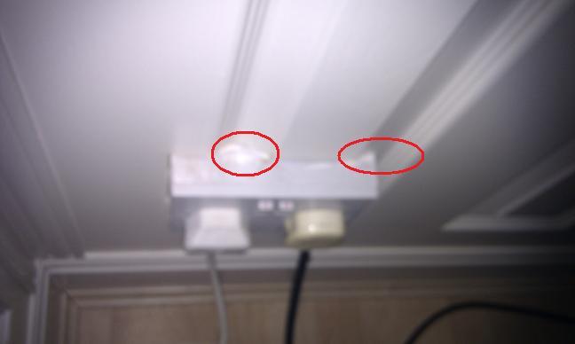

It's more the gap between panelling and socket that concerns me... if I put some sort of surround behind the socket I've got a flat surface for plate to align to.

Unfortunately because of the profile of the panels, the key issue is filling in the gaps... See the shoddy surface-mount-through-the-panel electrics currently in place:
So, I was hoping by fitting architrave around galvanised back boxes I could fill such gaps with wood and filler!
With the boxes sunk, the cable exit holes would be sufficiently below the level of the architrave for the cables (the box pictured is a 38mm box surface-mounted to the v. thick old plaster under the panels).
Ah I see what you mean now(not that your description was incorrect, it's just different to the picture i had in my head)
Erm well if you want double sockets, i think i would still go with dry lining boxes, cut the hole for the box(which is smaller than the socket) and knock out a bit of the wall behind to allow the box to sit flush, then offer up the socket, mark and trim the beading back to allow the socket to fit up to the box, you should be able to trim the bead back so it is a snug fit with the socket this way.
Or alternatively use single sockets in dry lining boxes in between the beading.
This all depends on how you want it to look though.
