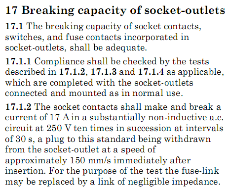

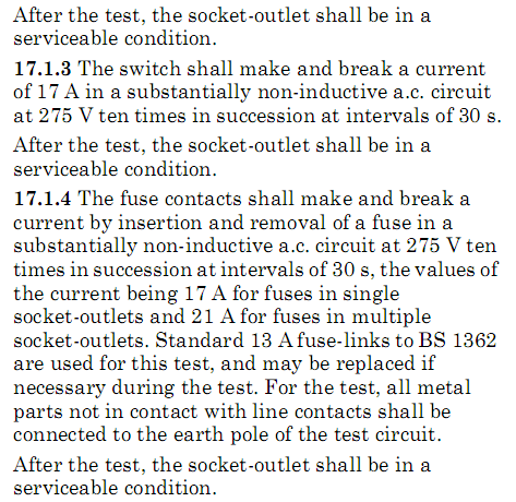

socket switches are able to make and break full load current.
For most makes that is true but only for non-inductive loads.
From the tech spec for MK plate switches "" Current rating: 20 amps – no derating when used on fluorescent or inductive loads""
The same "no derating" comment is not applied to MK 13 amp sockets
I might, of course, be wrong, but I would be rather surprised if BS1363 allows a switched 13A socket to have a switch which is not able to safely (and without damage) break a highly inductive 13A load. Does anyone know?
Kind Regards, John
Interesting. Thanks. I suppose the requirement for it to be able to break a "substantially non-inductive" current of 17A, means that it would able to break an "appreciably inductive" (but not necessarily 'highly inductive') one of 13A.
Dunno.
Or an extremely inductive load of a couple of amps? It's a TV power supply remember..
Indeed. In any event, I think that most SMPSUs have PF correction these days, so probably not a significantly inductive load at all.
