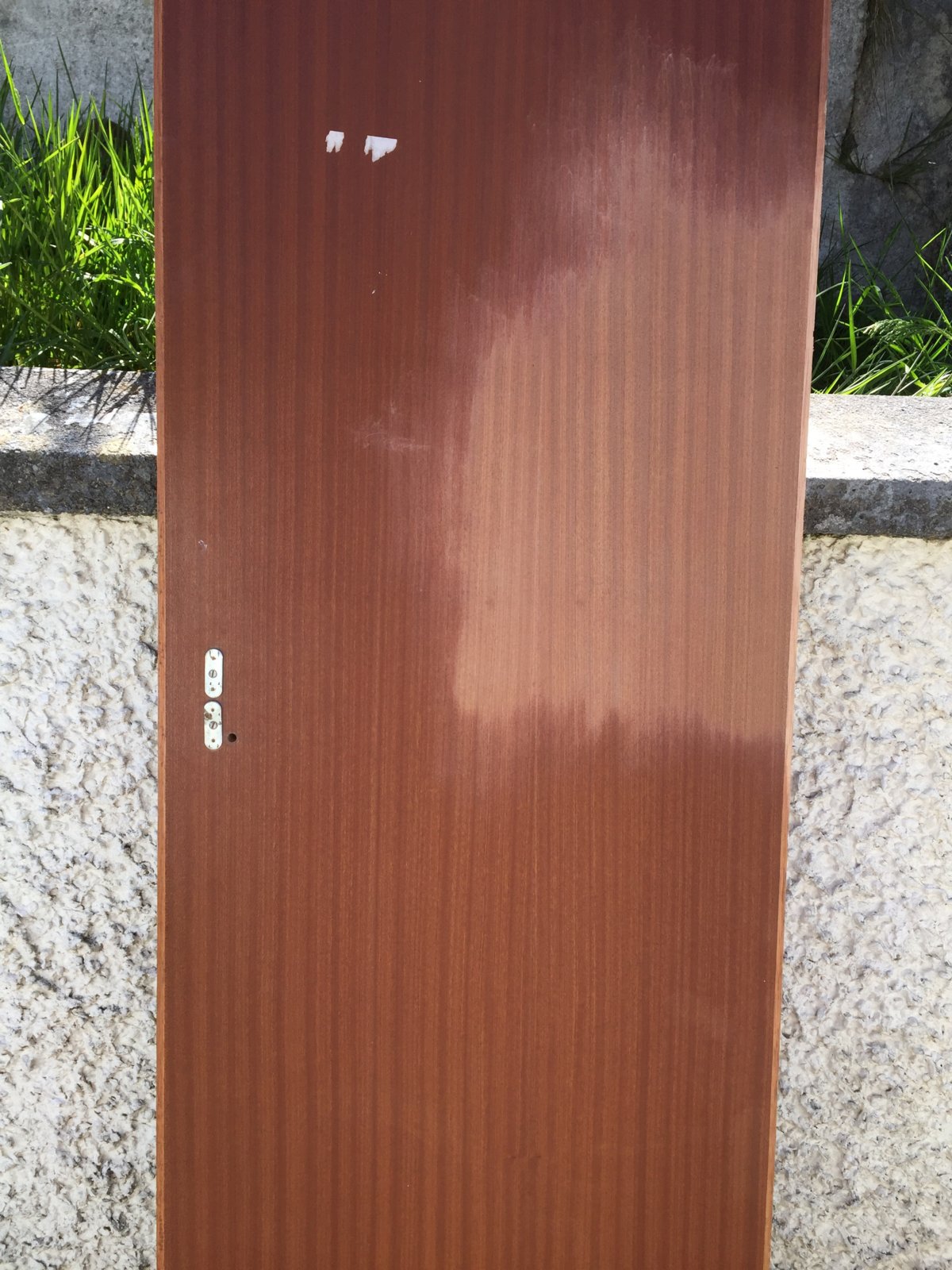

Hi, just moved into a 1980’s built bungalow, can’t afford to change doors just yet (13 altogether) they are the standard flat panelled stained veneered doors of the 80’s, I’ve sanded a patch and they have come up a nice lighter colour. I’m wondering if anyone else has done this? And if they end up looking okay or just a bit cheap? Also if I decide to go all the way, what should I finish them with? I don’t want to paint them, so a clear varnish of some kind?

I expect the veneer to be thin. Probably polyurethane varnish
I would buy a sander and fine paper and start really slowly so that you gauge the job as you go
Or even manuallly using a block
I would remove the doors a few at a time and sand outside as summer is here (almost) as you can sand them flat and also refinish them flat. Be careful on edges as it is easy to round off any corners
are they hollow doors?
if so, they cost about £30 new, so not worth investing a lot of time and effort.
When the time comes, I'd suggest something more solid. As well as feeling better, they will muffle sound more. Especially useful for bedrooms and bathrooms.
BTW a matt varnish will look better than gloss. Clear, not tinted.
I
Yes they are hollow doors :/ I guess I’m thinking about cost more than anything, if I were to buy new then I’d wait until I could afford solid doors but with 13 doors , the hardware and fitting that’s going to be a pretty penny! And my husband is not a DIY man! I’m just a bit sick at looking at the current doors as we’ve plastered, put down new light oak flooring and painted etc and the doors are now an eyesore as the varnish is so dark.
it will darken a bit when you revarnish. You can get an idea by rubbing the surface with a damp cloth.
That’s a good point! In that case they may be a bit too dark for what we want anyways. Any idea on what wood the veneer is? Thanks
I'd guess Sapele.
There are a lot of reddish tropical hardwoods that are inaccurately called "mahogany"
Yes I think you’re right, okay well thanks for your help, I think I might do the inside of one door and go from there.
