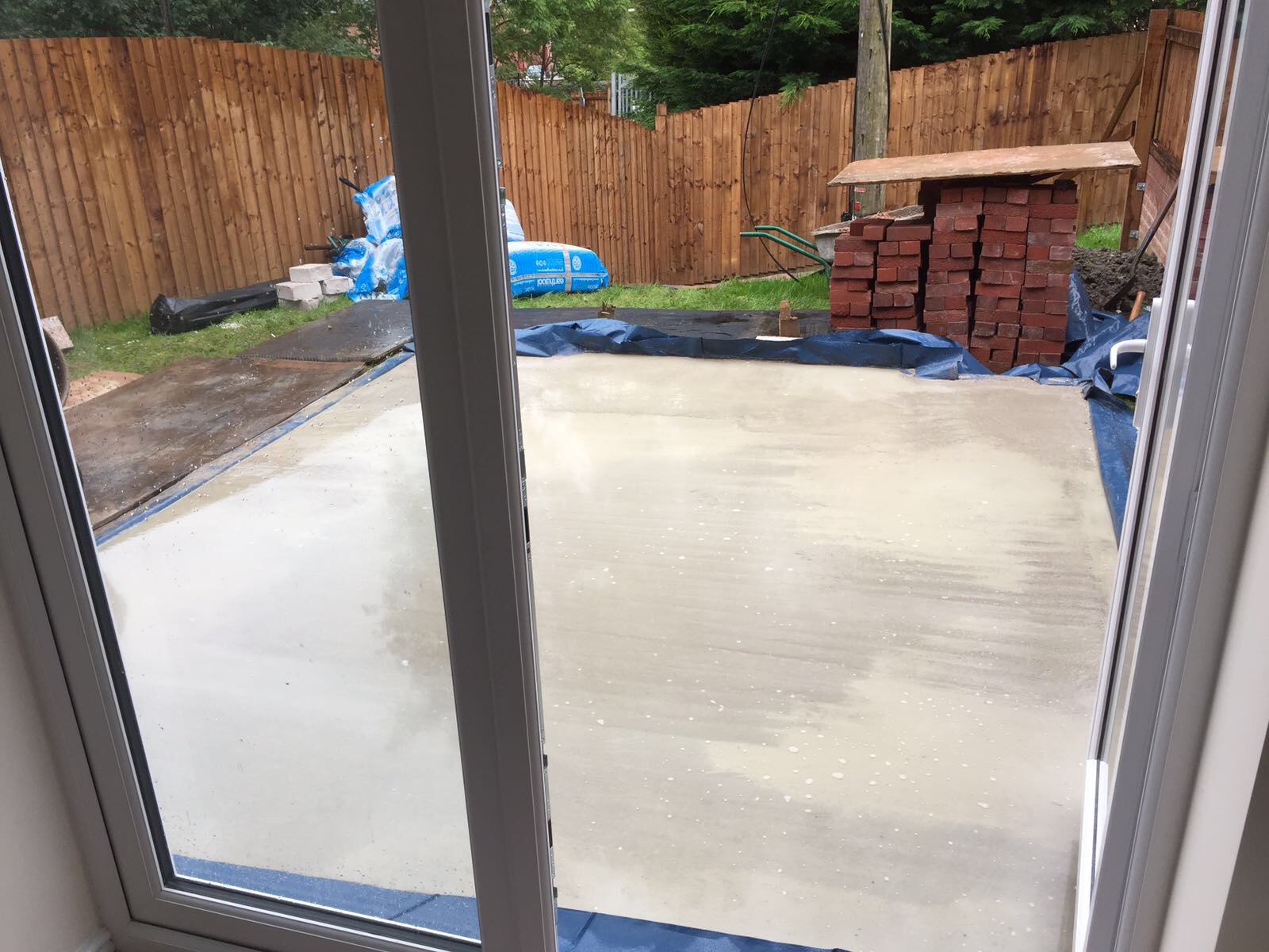

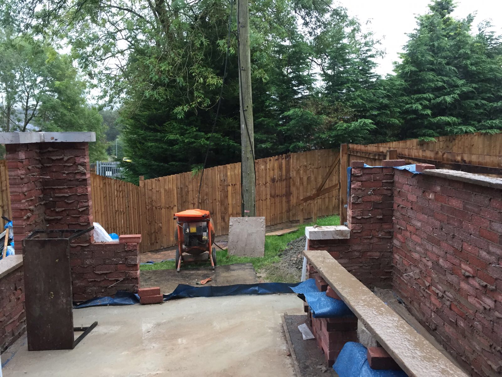

My mate is having an extension done for £1062/mtr although he keeps saying the roof is lightweight and comes in sections.
It's basically a 4x4 box on the back of his house. Brick and block, insulated floor and cavity, patio doors, big window, 1 radiator, plastered inside not sure about flooring.
I think the company are called First Choice. Couple of pics he sent me:

I agree, they could have laid a few more bricks with all that!!
Pi$$ poor when they leave the snots on the back like that. Just darn lazy.
Not just lazy, but all it needs is for some of those snots to touch inner blockwork, and hey presto you have dampness on inner face.
LOL. WTF is that pole doing in the middle of the garden?
If it was not for that he could have built in the ret of the garden instead of leaving that remaining bit of grass.
BTW aren't First Choice a holiday company?
substation over the fence as well (y)
