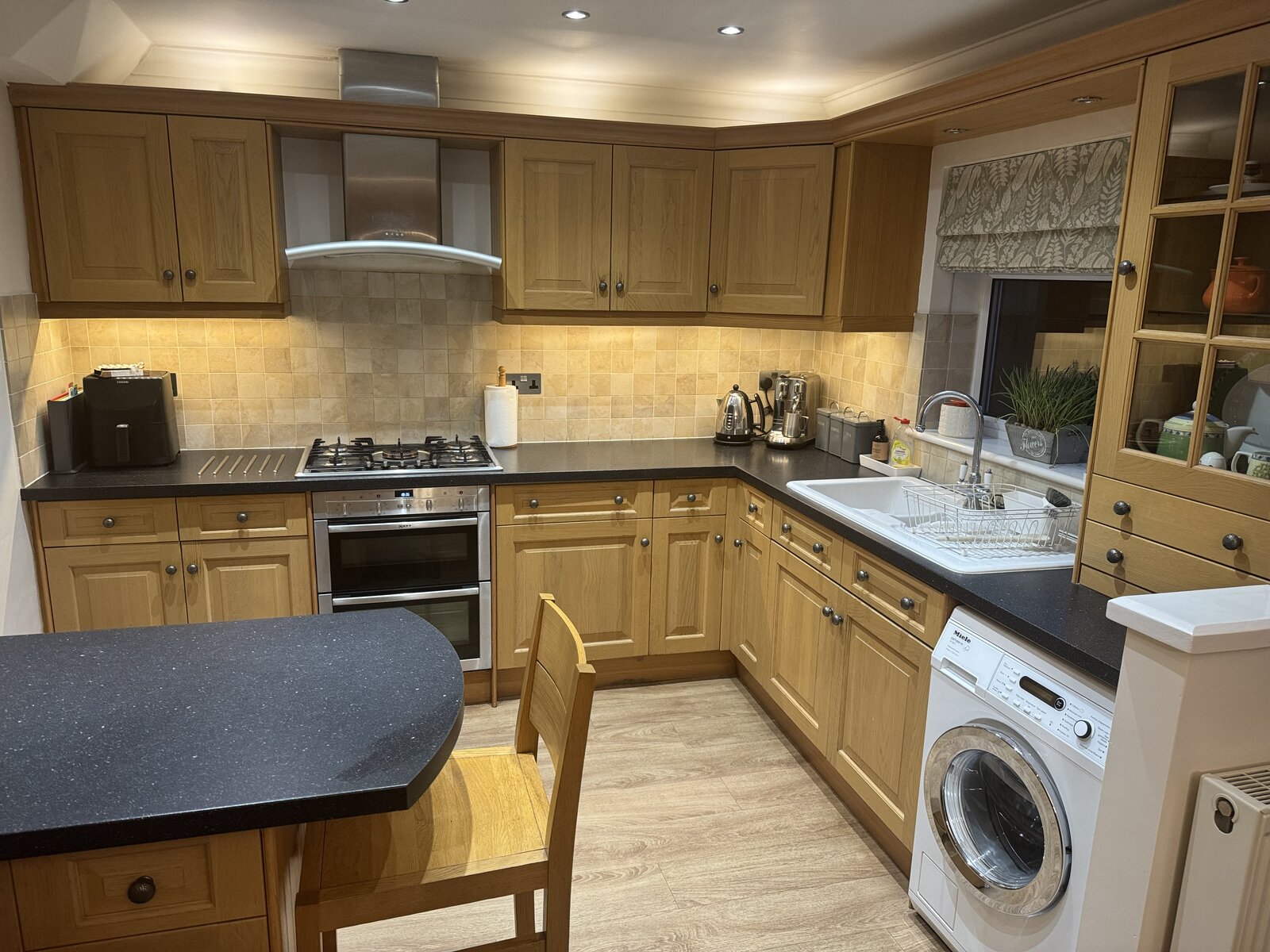

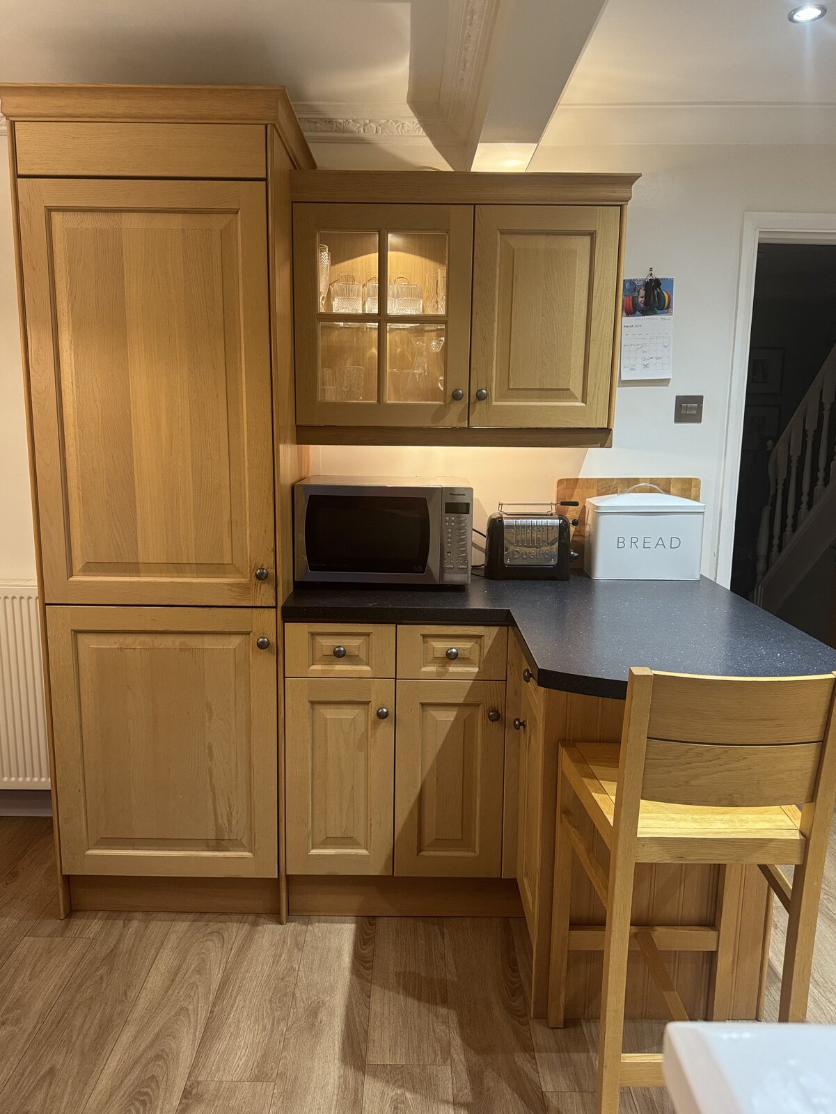

If you have a van and are handy, you can sometimes dismantle and collect a really good kitchen, in used condition, from someone refitting, to save them the trouble of taking it to the tip. Get one bigger than you need as it will not be the exact size and shape of yours and some items will be damaged. They may throw in accessories, sink and even appliances. I did this when I wanted a couple of extra wall cabinets and the range was discontinued, I ended up with a complete solid wood kitchen for a few hundred, and they gave me the dishwasher. I now have a very well equipped garage. Be very fussy about quality and condition.

I sold my whole kitchen with solid wood doors including sink, taps, oven, hob, cooker hood and integrated fridge/freezer for £250 just recently. I think the bloke got a bargain and it saved me taking it to the dump and going into landfill.
