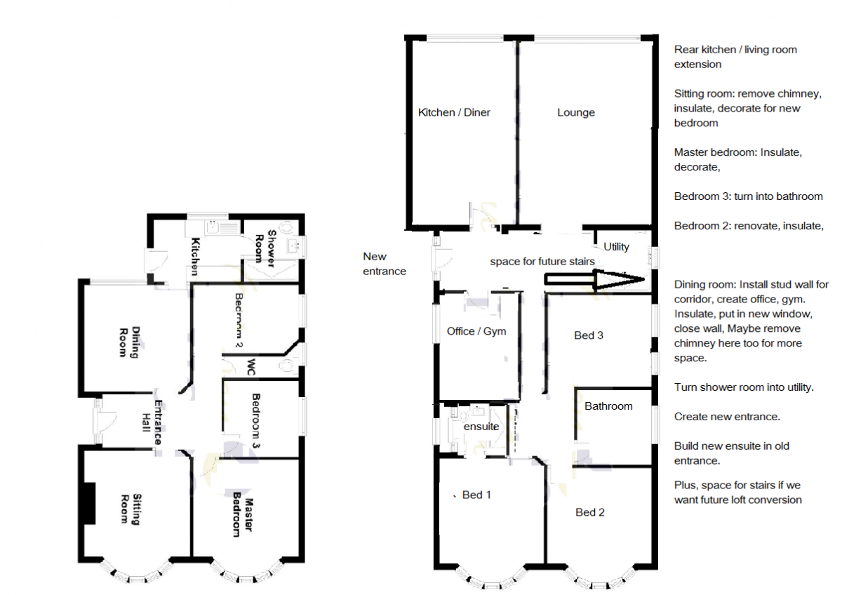

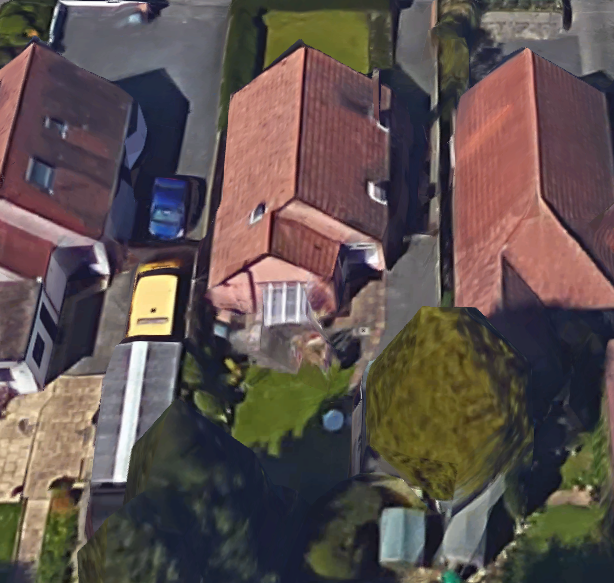

Want to do a single storey extension ideally a pitched roof that goes out by at least 6m, maybe 8m.... it shouldn't be affected by the 45 degrees from window rule, as neighbours are bungalows too, and they currently look at either their own garage, or the side wall of mine (obscured by tree in below photo). But, wondering, will council still say no, needs to be lower level? At 8m, it might be rather imposing. Also, will want it about 1m wider than current house, to fit 2 rooms next to each other.
Also, as going wider, is a flat roof part the only solution for that part anyway?
My rough plan, drawn up on Microsoft Paint.
If you mske it no wider than the house (ie drop the extra 1m) you could try the prior notification scheme and if no-one objects,
it is permited development by default and the council has no say.
The only snag is that you are limited to 4m overall height, which would probably preclude a pitched roof - maybe consider a flat roof with lantern?

You could apply first off for planning permission. But you have to show full drawings, and the neighbours get to see exactly what you propose, and may not like it. If they write to the council objecting, it gives the planning officer more ammunition to refuse it.
The beauty of the prior notification scheme is 1. it is free, and 2. you do not need to give them full drawings. A simple free-hand site sketch plan suffices (it doesn't even have to be to scale), and you just give the maximum sizes in writing. In many instances with these applications, I've noticed that neighbours often don't fully understand what's being proposed, and don't bother objecting - in which case the council has no input and it gets OK'd by default.
But try FMT's approach, getting the PN first, and then chance your arm with a full planning application.
Ah I see. OK, so for this house, there is no mention of any extensions on the local planning website. The neighbours house (on the right in that photo) has a notice from 1976, so I know that they once extended a little way. So, I can assume that never an extension done (certainly no sign of one) so I get do the whole 8m PD thing? Sounds handy!
well, one house is currently empty (sold, probate), and the other has their garage along there ... so if I get a move on, I might get lucky!
